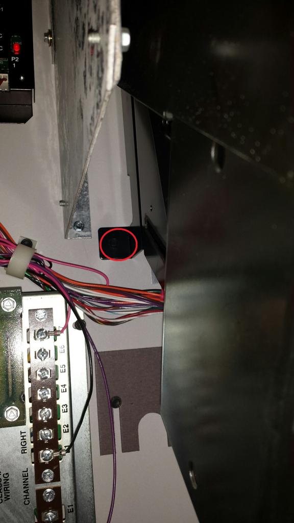

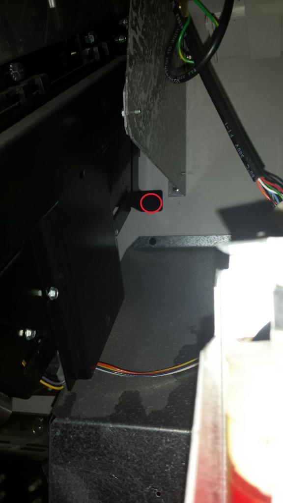

Secondly, I have spent over 2 hours trying to figure out how to raise the page unit into service mode so I can take a look at everything behind it. I have explicitly followed the instructions to lift up gently on the unit, then pull upwards on the 2 retaining tabs on either side of the unit. IT WILL NOT BUDGE. Do you guys think there are some shipping screws in the way that maybe haven't been removed? I can't figure it out for the life of me. I can take pictures or a video if that helps with you assisting me.

by Ron Rich » Mon Nov 03, 2014 5:55 pm
First of all --what's a Saturn II ? Model number would help--
Most of the later Rowe's that the pages lifted like that, had shipping screws through the rear outside wall of the cabinet--

by hirdlej » Tue Nov 04, 2014 5:29 pm
Ron Rich wrote:Hi,
Praise be to you Ron! Thank you! I looked carefully last night and saw the two shipping screws still installed. I would have never seen them unless you had mentioned it. I can't believe I had been looking for 2 hours trying to figure it out. I didn't want to break anything, so I kept my cool and slowly examined everything. This one had me perplexed enough where I had to ask for help ;)
If this can help someone in the future, here's the screws Ron told me about. They're black screws on black paint, not super obvious :)

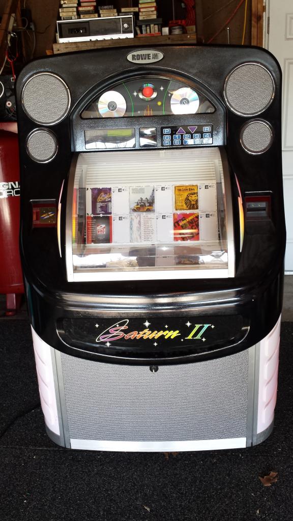

Now that I have the page assembly issue figured out, can someone tell me how to add animation to the pilasters? They already have the color wheels over the fluorescent tubes. There's just no motors or belts to turn them. I don't see any wiring in place or even where you would mount the motors. Any help would be greatly appreciated.
By the way, this is a CD100J model jukebox and looks like this:

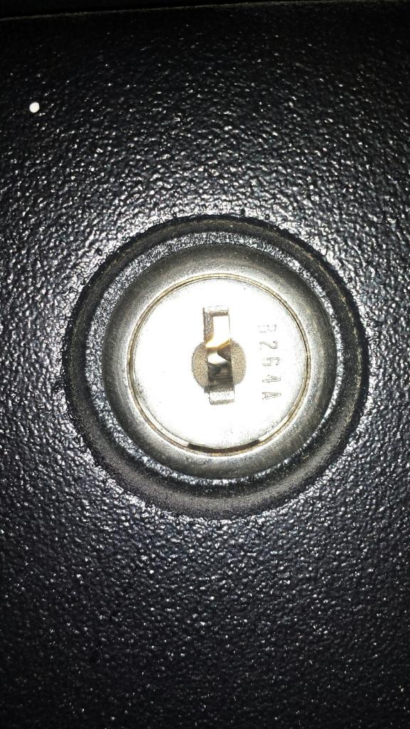

By the way, who made the coin door locks for AMI ROWE in 2001? I can't figure out who to contact to get a key. I would like to have this as complete as possible. Can anyone tell by looking at the picture what kind of lock this is? :)

by Ron Rich » Tue Nov 04, 2014 5:53 pm
The same company that made most all of Rowe's locks from about day 1--National Lock--any GOOD locksmith can make that key, using the code number on the lock--Ron Rich

by Ken Layton » Tue Nov 04, 2014 6:45 pm
National Cabinet Lock got bought out by CompX several years ago, but virtually all of their "National" product line is still made because they are so popular. CompX also bought out Fort Lock and Chicago Lock at the same time.
I was able to get National keys through my local locksmith.
