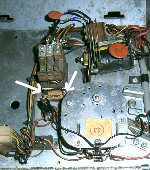

I tested the ADR relay by putting the probes either side of the coil, there's a rectangular 850 ohm 5 watt cap between both contacts, not sure if this affects the reading on the meter. There appears to be about 22-23v going there. I don't see the solenoid pull down. However, if I manually push down on the ADR so the switch contacts touch, everything works.
Picture of tabs I put probes attached.
Also, not sure if this causes the problem. The switch on the selector plate, by the wobble solenoid seems active all the time. While machine power off, I set the meter to continuity buzzer, and when I touch the 2 contacts of this micro switch, it buzzes, surely thats not right! I would have thought it would buzz when I push the switch on. Really is confusing me. I've studied the schematic and I'm sure the wobble plate solenoid and the micro switch are wired correctly.

Shows where I touched the probes

in case anyone in the future reading this post is interested of the outcome... I narrowed it down to the ADR relay, power was there but the relay never worked. However, if I manually pushed the relay down at the appropriate time the read out arm worked.
I removed the ADR and tested with meter, there was a break in the windings.
Have ordered a replacement... watch this space. I'll post the final results once its delivered and fitted. thanks again for all the diagnosis advise from everyone here.

Sometimes---you can "get lucky" on a relay of that type, when "open". Peal back the area near the solder-lugs, very, very, VERY, carefully. If the broken lead is on the "outside" of the coil, you can, "remove one turn", or, splice to it and re-solder it to the lug. If it's the inside lead, not broken where you can see it, you are, :cry: "outa luck". but if it's broken where you can see it, splice on--and enjoy your good luck !

You are spot on... as I peeled the tape back the wire break WAS on the outside, but being the clumsy person I am, the whole coiled wire came apart in my hands...Ooops!! hence the re-ordering a replacement!!!!!! If only I'd known before hand.. :lol:
