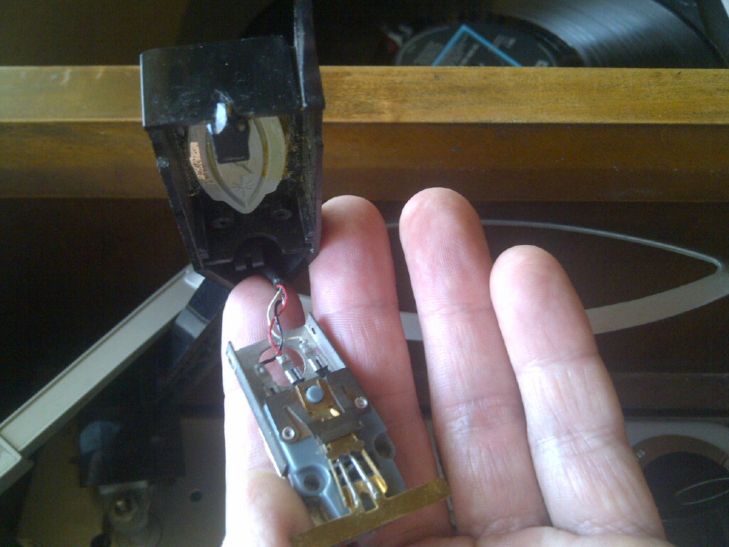

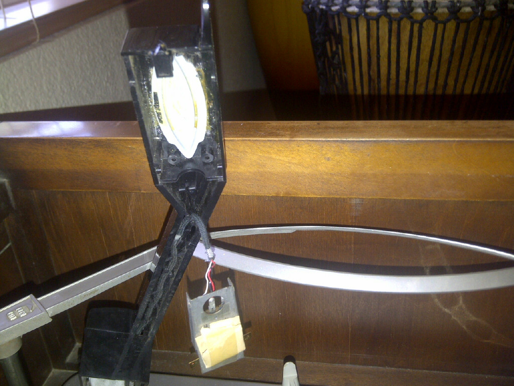

by rludym » Tue Mar 22, 2016 8:03 pm
here are 2 pics - the piece I bought from VOM doesnt make any sense to me - seems I need a pin instead. Thoughts? Thank you again!
Re: RCA Victrola Console RP-217B-22
by MattTech » Wed Mar 23, 2016 2:17 am
You better locate the pivot pin, probably somewhere beneath the changer.
It's not something easily replaced, being a specific size and all.
Someone must have been brutal to that changer to dislodge that pin like that.
And re-installation is delicate and critical.
Avoid damaging those very delicate wires and cartridge, or you'll really have a problem.
orthophonic
Posts: 36
by orthophonic » Wed Mar 23, 2016 2:50 am
Yep, you are missing the pivot pin in the rear, look underneath the changer in the pan. What did your 'friends" do to this poor instrument.
