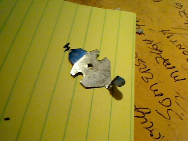

Normally, I would simply substitute another cartridge, but the way these tonearms are designed, it can only be replaced by the same cartridge. The metal mounting bracket that the cartridge clips into is riveted to the metal cartridge holder that is held to the arm by a single screw from the top. It is not held in place by two small screws like in a normal tone arm. On the cartridge holder is Magnavox part number 560305-1. There are only three wires with the flat terminal pins. The two negatives on this four-pin cartridge are connected with a tiny wire bridge.

Can you post a clear close-up photo of the cartridge? I am willing to bet that there is a cartridge available that will fit into the existing mounting clip.

I have seen several cartridges out there that come with their own mounting bracket. Some have both a single hole and the indentations on the side to use two screws. Garage-a-records used to (and maybe still do) have quite a few. I've got three Astronics with the black, curved tonearm, and they all have different cartridges with their own mounting brackets.--BB

FYI, I have a Magnavox console with a similar turntable with the curved black tone arm. It came with a EV 150 cartridge and according to the service manual it also takes an Astatic 461. They both have a single screw that attaches the metal clip to the tone arm.

Actually, I just had to pay some one to modify a similar vintage cartridge to fit. Apparently this took quite a bit of doing, but the problem is resolved! Hurrah. lol

I put a Shure M44E pickup into one of those. Of course, the pickup needs a magnetic pickup preamp.
I measured the point where the stylus is on both pickups, cut the mounting tab off the old pickup, and super glued it to the new one to mount it. Then I cut the two screw mounting ears off, so it would fit.
I had to make a second counterweight to counterbalance the heavier pickup. And the added thickness required reducing the maximum stack from 10 records to 8.
