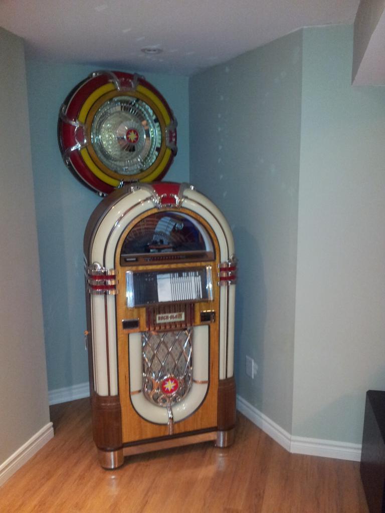

Thanks again for your help. Heres a pic of my setup.
http://i286.photobucket.com/albums/ll94 ... 64411c.jpg
