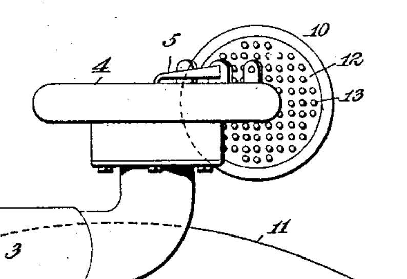

I found the patent
http://www.google.com/patents/US1634702

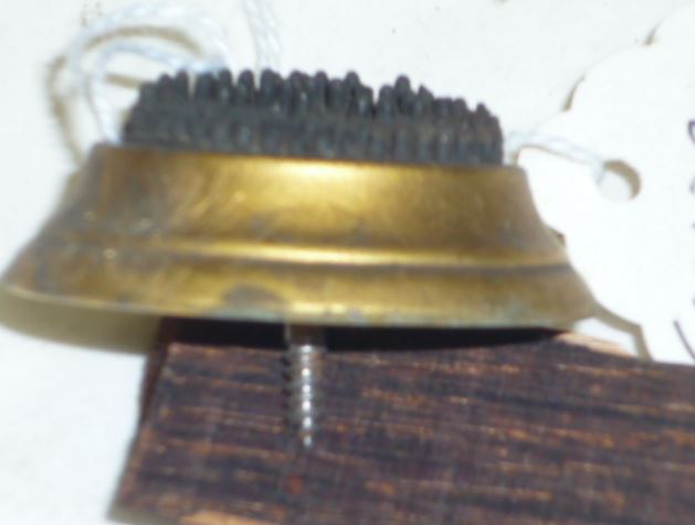

and here's one that was for sale at Phonographs.org --
sold unfortunately, but the rubber was probably shot anyway.
I know of no parts suppliers, specifically, that stock anything like this, but if you haven't already done so, you might try George Vollema at Great Lakes Antique Phonograph to see if he any suggestions -- http://www.victroladoctor.com/

I have a Sonora "Melody" table grand of c.1920 and had the same problem with the rubber needle rest. I carefully prised it out of its metal container and re-inserted it upside down. It looks OK.
