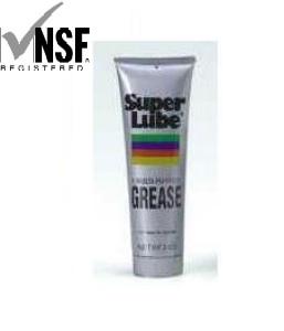

by MattTech » Tue Oct 28, 2014 7:11 pm
I gotta tell ya, the best grease I've used to prevent friction and wear on sliding/rotating mechanical assemblies is Super Lube with Teflon. (PTFE)
Widely available, it's light, clear, and sticks where its put.
Also sheds dust, is waterproof, and super slippery.
I've used it on VCR's in the shop, record changers, and gearboxes of power tools.
Great stuff.
http://www.aaaindustrialsupply.com/ProductImages/superlube/3%20oz%20tubeNSF.jpg

Thanks for the info! I hadn't realized that Dow Corning still made DC-44... I see it comes in a medium and a light variety. I'm going to order the light version and see what that looks like.
That "Super Lube Teflon" grease looks good too, I may pick up both and see what consistency I like best.
