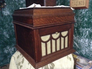

Just finished restoring the case of a Starr phonograph. Please tell me what you think.

I think the picture's blurry.

HI, it looks fine but camera is not. need a better picture.

Right-clicking the photo and selecting "view image" gives me a better idea of what it might look like, but I agree with the others--the photo is way too grainy or blurry . In the photo, as it now appears, the cabinet seems to have been stripped and a a coat of danish oil or something similar applied. I'm sure you went to more trouble than that.

I know I'm no photographer. The work needed to bring the piece to where it is took some doing. I believe it was probably left in a shed. The wood grain had opened up considerably, and the laminate (on top of the lid) was gone. I lightly sanded the rest all to smooth, and relaminated the top. With out removing all the original stain I applied more slain then waxed all. I do apologize about the picture quality. Thank you all for your input.

I took the picture with an iPad, but the image was to large, so I took another further back and cropped it.

I think this is the best I can do.

I can see, now, that it's oak, and it looks pretty good. It sounds like you did an authentic job of restoration.
Does it have all of its innards?

Working on it I repaired both springs, but it needs new gov springs, lower speed control mech, felt iwashers to isolate the motor from the motor board, needle cups, stop bar for tone arm, one tone arm nut, and a sound box rebuild.
