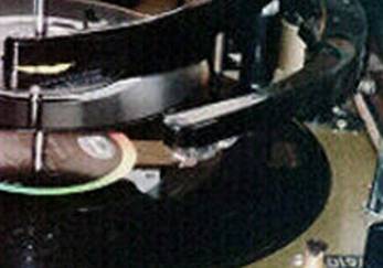

Nothing wrong with the change cycle except that the record needs to be up on the spindle. Here is a picture of mine scanning the size of the record with the pickup arm. The arm scans, and then the record drops. it shuts off if it doesn't find a record.
Incidentally, on the models made before 1967, the arm scan measures the size of the record accurately, so odd-sized records can be played. The only restriction is that smaller records must be above larger records. It should hold 8 records.
There are two drive wheels wheels in the earlier Magnavox changers. The one on the left of the photo runs the turntable, the one on the right runs the changer cycle.
Are the drive wheels good, with smooth, but not hardened rubber on the edges? If they were replaced with replacement parts made after 1970, they might still be good, but the originals deteriorated rapidly in humid weather. If the wheels are good, the motor bearings, idler pivots, idler bearing, and turntable center bearing need to be cleaned and lubricated.
