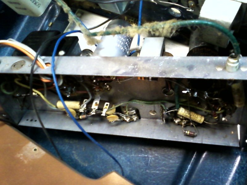

Hello, I'm new here and found this site because of the trouble I'm having with my record player. I've stumbled into a 1957 Calypso that is not working. The radio is new to me and I'm not familiar with radios in general as most of my hobby time is spent wrenching on 50-60 year old sedans. When I plug the radio in and turn the machine on, it will begin the process for dropping a record onto the turntable and all of that appears to be behaving fine. In fact, I can heard the record as it runs across the needle and it sounds correct. My issue is that the speakers are not playing any sounds at all and what appears to be a main power transformer (largest black transformer under the front panel) is heating up to an extent that it stinks like burnt plastic and sounds like it is boiling something. I suspect the transformer core might be submerged in oil or some other medium and that is what I'm hearing but I've honestly got not clue as to what is making the boiling sounds. When I unplug the unit, the sounds continue for 15-20 seconds but quit and eventually the smell goes away too.
I have no emotional attachment to this unit other than it looks cool and would be an excellent addition to my shop. I'm inclined to gut the fiberglass shell to put modern components inside and just keep the cabinet for looks if I'm unable to get it working properly. My suspicion is that it is not worth fixing to original working order and it may as well be able to play some MP3's or something if I'm going to keep it around. I thought I would check here first in case there is an easy fix to the player.

Don't take it personally. If you didn't cook the transformer, though I'm afraid you may have, this phonograph may yet be salvagable. That said, this is one cool phono and I would certainly restore it if it was among my stash.

Thom wrote:Don't take it personally. If you didn't cook the transformer, though I'm afraid you may have, this phonograph may yet be salvagable. That said, this is one cool phono and I would certainly restore it if it was among my stash.

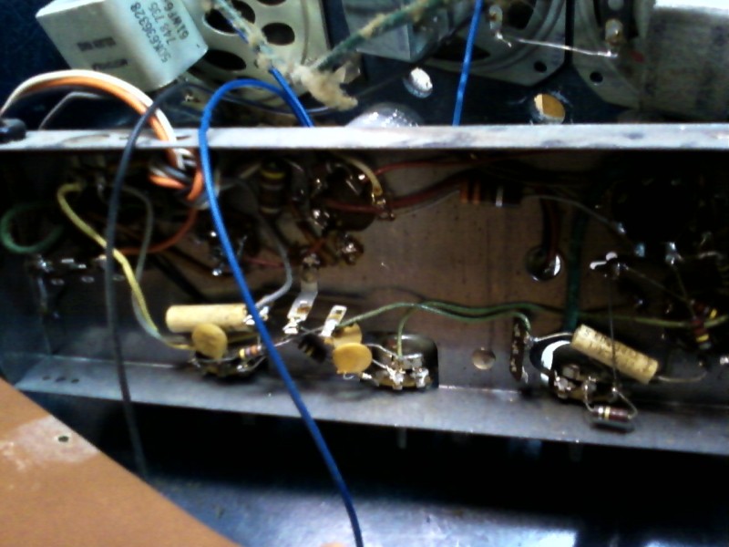

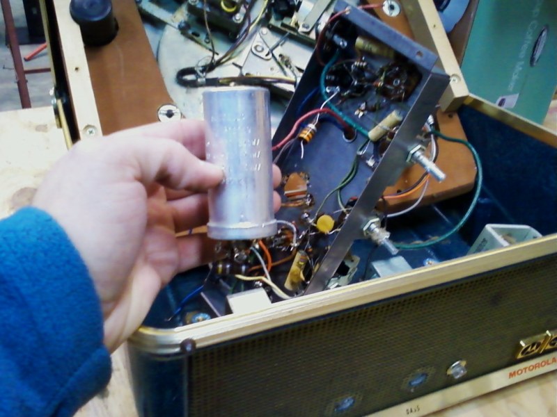

Considering that the entire device comprises discrete components, I'd venture that $50 or so would have every single electrical item under the chassis cover replaced. Not really necessary in my case as I found out. Anyway, so this little guy was my problem:
Likely anyone else that bumps into one of these (or any other old radio/tv for that matter) will recognize a dried out filter capacitor. Just a dead short across a $15 (full retail) item that is a simple fix and a reminder that most TV/radio repair jobs are no more professional than any other monkey replacing like components with a soldering iron. Sadly there a lot of lazy/uninformed people out there who are willing to pay big money to get such minor things corrected. Seems that there are still enough shysters willing to take advantage of them though, so that's good. Transformer seems to be fine though I won't know for certain until I get the machine powered up. Considered wiring a trio of 40uf radial caps in lieu of the big daddy to hear it play this evening but I didn't have any large enough on hand. I'll swing by Radio Shack tomorrow and see what they have. If I have to order anything I'll just get a direct replacement. Once I get it running properly, I'll pull the guts out, shelve them and use the case to house a laptop for MP3's and all that jazz.
btw - I took these pictures in case anyone else has one of these players and is curious about what makes the magic happen underneath:
Hardly the kind of rocket surgery that requires professional service.
Re: Need help with a Motorola Calypso 3H24 portable phonogra
by Thom » Tue Jan 04, 2011 12:47 pm
In that those cans are almost never available I always replace it with individual ones hidden within the chassis or for my more important restorations I gut the can and insert them in there. I doubt RadioShack will have what you need in those voltages. Alas, they no longer serve the electronics hobbiest, just games and gadgets. However, those values are available on the net. I generally get mine through {justradios.com} but there are other sources as well.

Probably the insulation inside the transformer failed with age. Or some liquid may have been spilled in it.
Or if the power supply is a selenium or silicon rectifier, it may have failed, or the power supply filter capacitor may have shorted.
The transformer is the hardest part to get and the most expensive part in any audio equipment.
