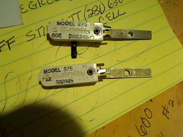

Scrap the console model number, but you are spot-on with the cartridge number. I've never seen a 560305, but with the numbers being so close, it may be similar to the popular Magnavox 560345. You may find other numbers on your cartridge like an Electro-Voice EV275 or an Astatic 165D. --BB

The Magnavox cartridge 560305-1 is nothing like the EV275 assembly.
Basically the 560305-1 is an EV149D in a wider bracket. 3G, 0.5V
Either a 149D can be snapped into the bracket, or a 150D, with a tad more stylus pressure (4-5G), or get an Astatic 461.
