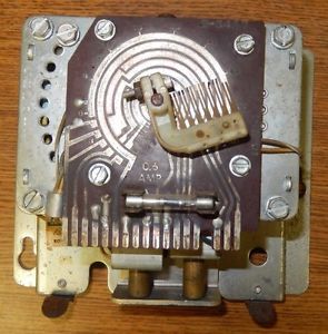

Steve, since you are adding credits with the button the first thing to check is the fuse on the credit unit. It is on the board where the credit wiper goes around.
Here is a credit unit with wipers and fuse shown:
http://i.ebayimg.com/images/g/GzgAAOSwL ... s-l300.jpgWhile you have the cover on the credit unit open it is a good idea to clean the traces with an eraser and rinse with rubbing alcohol.
