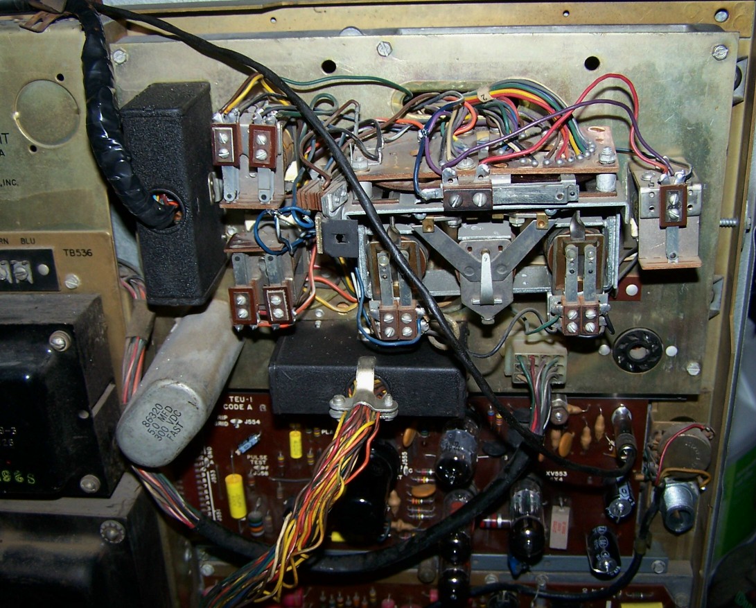

Here is a photo of a 100 selection Seeburg L I own. It has had the modification mentioned in this posting some time in it's past.
Looks like wiring the jones plugs would be a real pain!

Do you have any "paperwork" on that unit ?? Wiring the new plugs would really be no different then if you needed to change one--NBD, just 30 some odd wires to cut and solder---?
