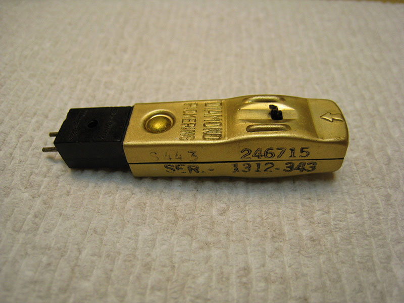

Just curious if anyone has ever used a Seeburg gold cartridge? I just picked up a Seeburg 200c-1 or 2 and I thought that it originally had a gold cartridge. Mine has the red head cartridge. So I bought a gold cartridge from a collector and ordered a manual for the phonograph. In the manual it states that there were three cartridges available. One was this gold cartridge, but it also states that the gold cartridge had a permanently installed diamond needle and that when it wears out you replace it with a new cartridge. The other two available cartridges used replaceable needles. One was sapphire and the other was sapphire or diamond.
So my question is has anyone ever used one of these gold cartridges,
seeburg gold.jpg (97 KiB) Viewed 158 times
and if you have, can you change the needle or is it soldered, crimped, etc in place where it wont come out?

Doesn't the manual give part numbers for the 3 carts ? The 246725 is the one that originally was equipped with diamond re-replaceable needles--Exactly the same cart as the "blackhead" 245789, 'sept for color .
Hint: See the "arrow" on the tip of the gold cart. it points down on this side and will point up on the other side to indicate which direction to install the new stylii. Ron Rich

The manual states that "There are three pickip types, two of which have replaceable styluses or armature assemblies."
"Stylusus for the number 245789 cartridge ....." uses sapphire styluses only. Part number 245795. "This cartridge is associated with Type PA2-L6 preamplifier only. "
"Stylus armature assemblies for the number 246796 cartridge are available in sspphire or diamond as part numbers 246797 and 246788 respectively. This cartridge is associated with the Type PA4-L6 presmplifier only. "
"The number 246715 cartridge (with gold finish is equiped with permanently set diamond styluses. The entire cartridge should be exchanged when the styluses are worn. "
Only one parenthesis in that quote.
So although the gold one looks just like the black cartridge, I am wondering if the stylusus can be removed and replaced.
The preamp for thst cartridge is not mentioned either. Why would there be a difference in the pre amps?
Re: Seeburg Pickering gold cartridge 45 rpm
by Rob-NYC » Wed Sep 21, 2016 4:37 am
Larry, if the stylus is replaceable it will fit into a slot such as this on a black cart:
http://s1192.photobucket.com/user/Rob-N ... rt=2&o=228
The styli came with a tiny cardboard tool that slipped onto the angled portion of the cantilever and it was extracted by pulling it straight outward from the cart body
The preamps may differ in how they load the cart due to cart impedance. A black one here measures 488 ohms. this as compared to the typical mono red which is in the 1.7k -2.2k range.
The whole idea of non-replaceable styli makes no sense in these primitive carts. In the 1950's and well into the 70's it was felt that some improvement in tracking could be had by more intimate coupling of cantilever and armature. In reality, I suspect it was just another revenue stream for the cart makers in retipping them. Bang and Olufsen maintains this practice even today as do some of the "boutique" (read: AudioPhool) brands.
