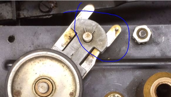

For anyone that followed this tread, since I started it, here's the conclusion of it :
(Thank you Eddie for the image you posted. Actually the spring was connected to the right place on my machine but the picture here will explain by itself what was the issue. I have to buy E clips).
As you may see on the picture, the idler wheel pivot was an issue. The mechanism was stuck. I only had to oil it. Then the idler wheel made contact with the motor shaft as that thing was able to move.
I changed the motor as the original one had been broken. I understand that I have to change the tension spring and probably the idler wheel, I'm on it ! I was able to play discs ... at the wrong speed but it is a start !

Try cleaning the rubber on the idler wheel with a "safety solvent" ,and also the contact area on the turntable. What condition are the motor supports in--often, if bad, these will cause a slow running situation. The idler wheel can be re-surfaced--see list of persons above who do that--

Spring looks like it's still hooked up wrong in the picture to me..... In the picture, there is a lot of distance in between the roller and the shaft and the spring has zero tension on it. Post another pic since you oiled the pivot. The object is not to pull the roller against the platter, it is to wedge the roller between the motor shaft and platter, putting equal pressure on both. When this is correct it is hard for the motor to slip.

Hi Eddie, the pivot is now unblocked and the wheel does contact the motor shaft. But I would prefer to wait for a new spring before posting a new pic, I know I will have comments on using the wrong spring ;) Unless you insist !
With the wrong spring attached, I get a irritating fluctuating sound but the platter still gives a 45 rpm. From all the comments, it looks like the cause is the idler wheel/rubber and the spring. I'll change both and will post here when done.
