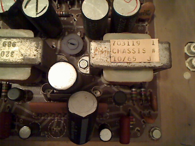

I won't go on a tirade about newbies not reading older posts, so I'll try to be of some help. Your console looks to be about 1966, and if you remove the back panel of of the unit, there should be:
(1) a date sticker on the receiver barely the size of a postage stamp like "Chassis, 10/65" (October, 1965);
Picture 27.jpg (105.48 KiB) Viewed 2043 times
(2) possibly another one that may say something like "Chassis, R204-13-10" or that number could be stamped in big letters on the chassis. The one pictured above is an A575-01-00 chassis and there may be another stamp somewhere on it;

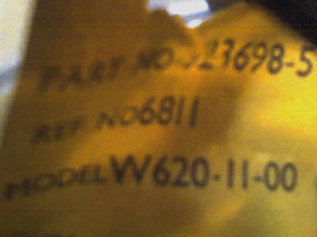

(3) turntable model number on a sticker on the underside of the turntable, can't recall a date sticker on that.
Micro-Matic #2.jpg (24.6 KiB) Viewed 2043 times
Maggie W602-W608.jpg (29.29 KiB) Viewed 2043 times

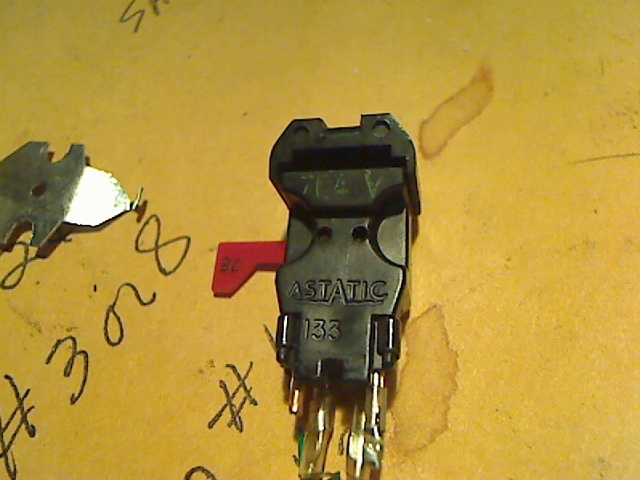

Before getting a new needle, get the number off the CARTRIDGE. It's also considered a separate entity.
Picture 32.jpg (95.88 KiB) Viewed 2043 times
ElectroVoice 275 = Magnavox 560345
Picture 8.jpg (95.99 KiB) Viewed 2043 times

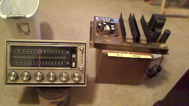

Each section is treated as a separate entity and has it's own service manual. Forget about the Cabinet model/serial numbers. Cabinets have been used for several years, so they may house upgraded turntable/amp/receiver combinations throughout that cabinet line. That's why it's important to have the model number from each section in YOUR cabinet.
Astro-Sonic 100: separate amp, receiver and turntable
Picture 126.jpg (78.04 KiB) Viewed 2043 times
Okay, I'm babbling again and sorry for so verbose. Just wanted to give you an overview on how things are packaged in a [at least my] Maggies and/or consoles in general. You may have to get a flashlight and mirror to look on your receiver to find the date and/or model sticker(s). You're lucky to have a console that is fully functioning.
