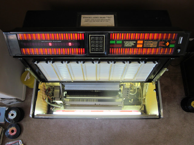

If you look at his pictures the mech is slid up almost touching the front lexan panel instead of back where it should be so it literally shades the florescent lamp from much of the front orange panel. I agree the mech should be locked in place but his is slid up front. You can see it's silhouette.

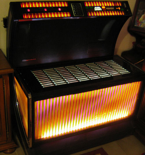

Here is a pic of my USC2 showing the correct spacing between the Mech record rack and the front.

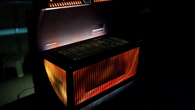

Here is what it looks like AFTER mild cleaning ...
