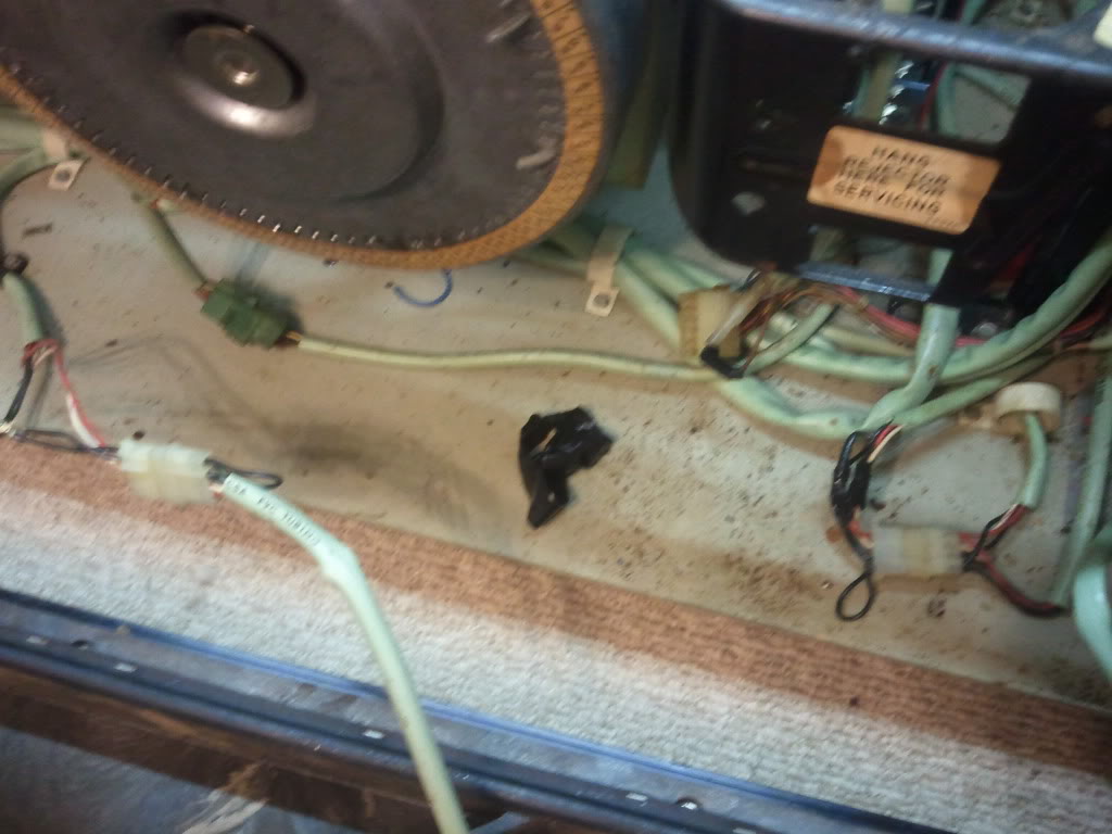

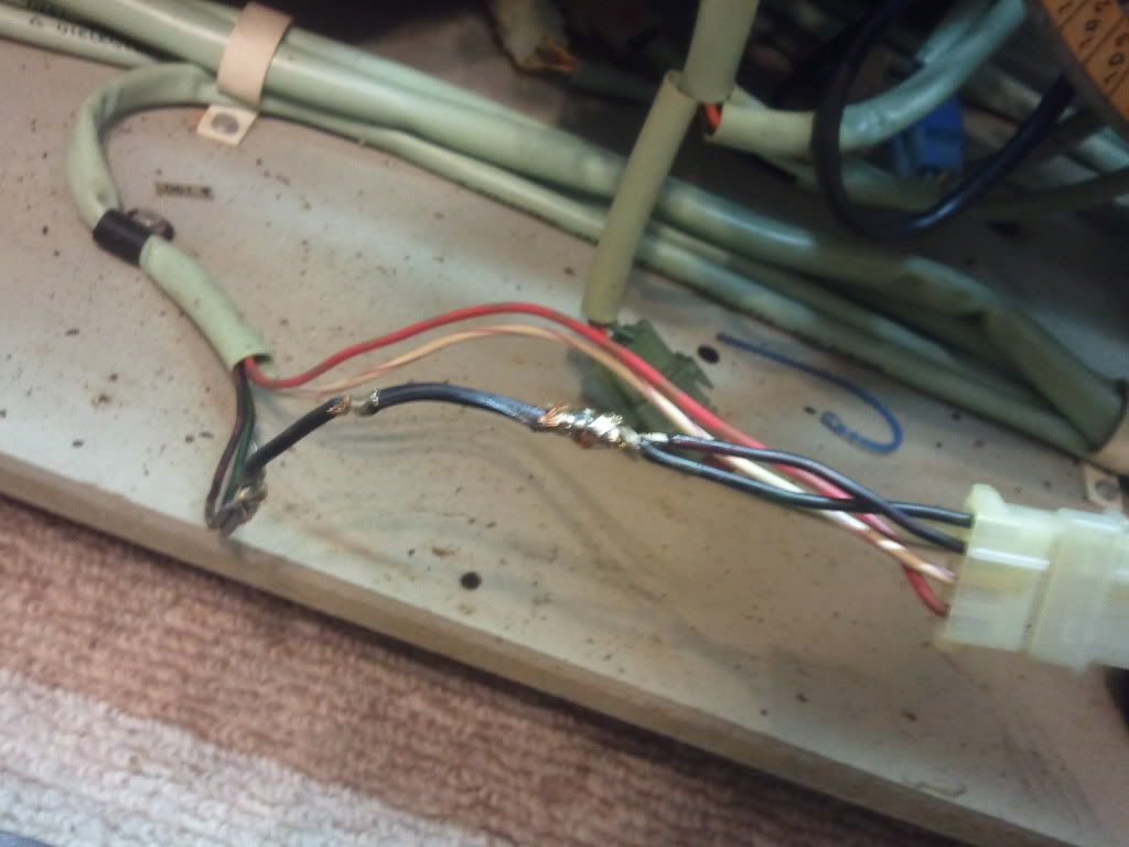

by v1point0 » Mon Sep 12, 2011 4:21 am
Ron,
It's been awhile since I have been able to work on my Juke with summer and some if the other projects I have been spending most of my time with. But tonight I had a little time and decided to start trouble shooting my amp/speaker problem. Well, months ago a friend and me moved the Juke from my garage into my house. Now when it was out in the garage both channels did work but the left was very weak. Now the right is completey non-existent and te left seems fine. I started to check for something that may have jiggled loose but I didn't see anything in my first inspection. I checked continuity from the needle connections to where it plugs into the preamps and everything checked. I open up the amp area to see anything obivious that might be loose of damaged but nothing. Then I started to check the lines going to the speakers, easiest ones were the woofers. I noticed a lot of electrical tape and took some off to find what is in the picture. There is another spot in the second picture in the right that has the same soldering job. Do you have any idea as to why someone would do this? I'll keep checking wires and will need to pull it out to check the lines right behind the back panel but I thought I would ask you to see if you had run into anything similiar.
Curtis

Re: Rock-Ola 464 Help
by v1point0 » Mon Sep 12, 2011 7:14 pm
Ron,
Hmm..interesting thought. I didn't notice that the output from the amp from the top comes down to the junction seen in the bottom picture lower righthand side (above) and then from there it is split; one set going to the woofers (the first picture's solder debacle) the the other set going to the back. What exactly does that panel in the back (located right behind back access panel near the bottom of the box) do for the speakers? Because when I unhooked that junction, taking out the set of wires that ran to the back and just hooked up the wires going straight to the woofers, there was no sound. I'll post some more pictures tonight so you can see exactly what I am talking about. I'm hoping there is just a loose wire or something simple to fix rather than having to fiddle with the amp section.
Thanks Ron,
