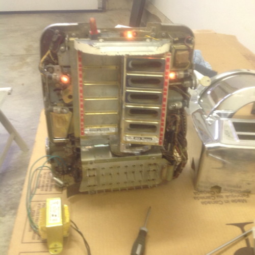

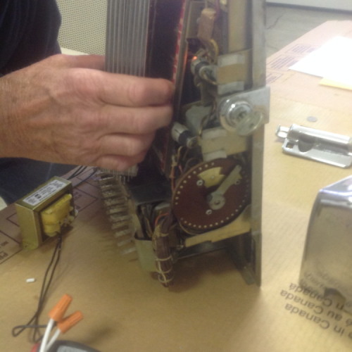

I am trying to restore my wall box and I am new to this never did one before . I bought a 25V transformer and connected it up I put a quarter into the machine and it took it I tried pushing the buttons but they will not push only the bottom row(numbers only) will push in. Some of my lights work and some do not. The arm on the selector plate moves to the next dot but that is it. So it seems it is not getting power somewhere Any suggestions out there?

highriverguy wrote:I am trying to restore my wall box and I am new to this never did one before . I bought a 25V transformer and connected it up I put a quarter into the machine and it took it I tried pushing the buttons but they will not push only the bottom row(numbers only) will push in. Some of my lights work and some do not. The arm on the selector plate moves to the next dot but that is it. So it seems it is not getting power somewhere Any suggestions out there?
"High" Yeah, I have some suggestions;
First, a question; why are there three wires going to the transformer? There should only connection to the orange -chassis and green -AC input. the third is blue-signal and not needed at this time.
Next, it is item to oil the motor and gears before doing anything further. Use a good 20wt and be sure to put a drop on all cam faces as well.
-When credited the wiper blade should form a "V" as shown here:
http://s1192.photobucket.com/user/Rob-N ... rt=2&o=230 In this position the buttons should lock in when pressed. the wiper blade should not be able to be turned counter-clockwise in this position.

Thanks Rob and Rich for all your advice I will go back "to the drawing board" and go over the list you gave me The third wire going to the transformer is the ground wire

On the transformer-- the AC hot goes to the green terminal--the AC return to the orange terminal ( ground screw)--the "blue/signal" terminal should be vacant, when using an external transformer to power the WOM.

Rob I am going to try what you suggest Do I have to tear the keyboard right apart or can I leave as is and lubricate that way I guess I am afraid of lubricating something that I should not be doing
Re: Need help with Seeburg V3WA Wallbox
by Rob-NYC » Tue Sep 27, 2016 6:26 am
"Guy", you don't take anything apart to lube the box.
There are gears to the left of the motor that need a drop or two of oil as well as on their shafts. The motor shaft needs a drop on both left and right sides. There are also gears behind the wafer and these can be hard to get to but use a "zoom spout" type hose oiler to snake between the wires. The same oiler is used to put a drop on the can faces and the splines that goes through the keyboard from left to right.
A bit of spray contact cleaner and lubricant can be applied to the inside of the keyboard sections when the cashbox is removed.
