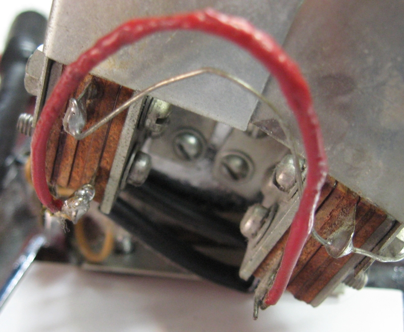

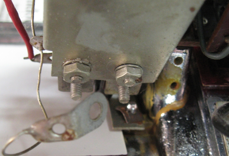

For an update i did get it to work today but still have problems. I decided to pull the push button assembly out and give it a good Deoxit cleaning. Check out what i found. Wonder if the lack of a ground caused the one red wire to get hot and is a source of other problems

I do not have a C manual--the 4 pin, coin plug, is self explanatory --One each wire goes to/from, a coin switch, to a coin coil. The 4th wire is "common"--just observe the switches. Also, near he socket, you should see a "faded" green dot. This "dot" aligns with either the (green-faded) dot on the plug, or on later plugs, the "extrusion", on the round section.
As for the ground--yep--I would think that it should be attached ----
If the wire(s) to the solenoid look burned, probably some one has changed it. These are KNOWN for catching fire, which is why I sell the ( GOOD !) free-play/fire prevention kits. Ron Rich

Did a little more work on it today. I used the common wire (25 volt) on the socket and found that if i connect to the top of the credit switch it would activate the 25 cent solenoid. This is where i had it jumped with a test lead. Moving the jumper around would break and break the circuit ! Talk about driving you nuts. So i soldered the wire in and now all is working. 1 play Nickle 2 plays a dime and etc. Even the push button are working correctly. It would stay on the first letter you punched in till it was done with the selection. Funny how a ground can help things work. I am slowly making progress and even learning new words !!!! :D :D :D
