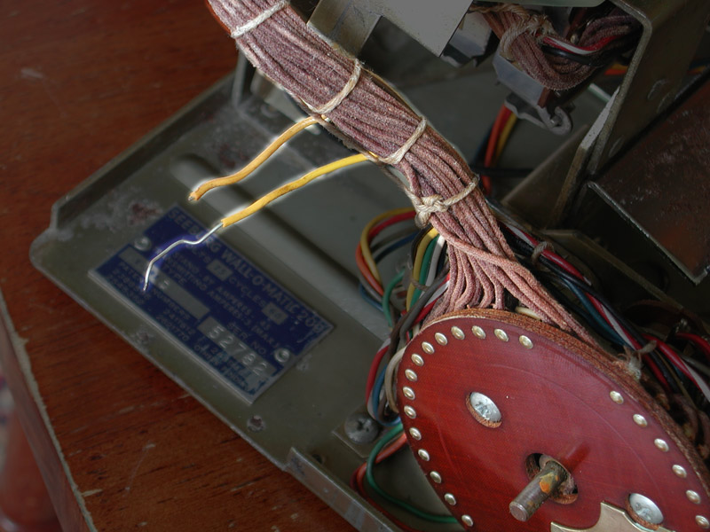

It is going to take me some time to rewire this. There were some wires obviously cut and re-wired to different places, some wires just found dangling etc. I have the schematic so I should be able to get this working again, eventually. Right now my biggest mystery is the two yellow wires coming out of the harness between the button assemblies and the rotor. It would be a huge help if someone could look at their own WOM 200 and tell me what these are for, and maybe snap a photo if possible.

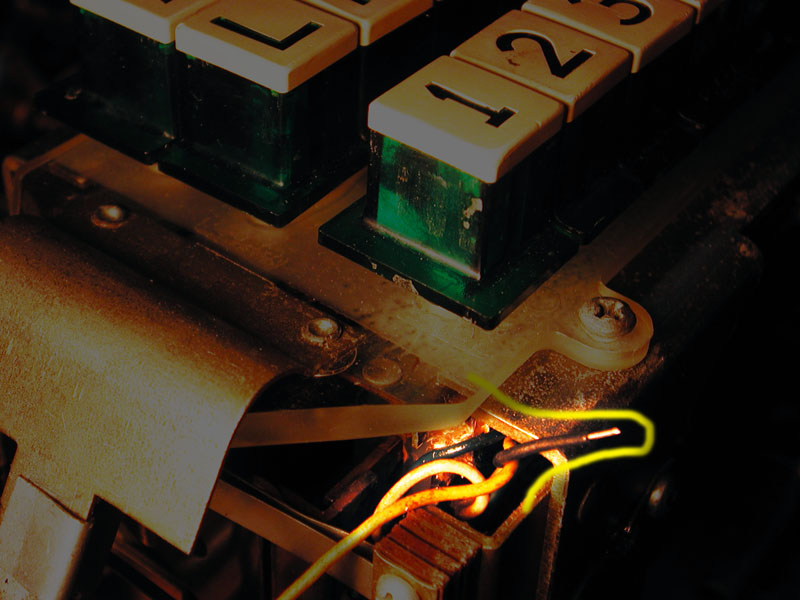

The dangling yellow wires may go to the keyboard light, but I am not sure. Someone completely rewired all the lights.

Mystery yellow wires

Yellow wires on all WOM's, are for the general illumination lamps-"Hot side"--from the autoformer. Ron Rich

The yellow wires in question are for the keyboard diffuser lights. Those two go together on the center contact on one socket and there should be two black ones for the 'can" contacts. A yellow and black wire run under the inside front of the keyboard frame to the other side's socket.
