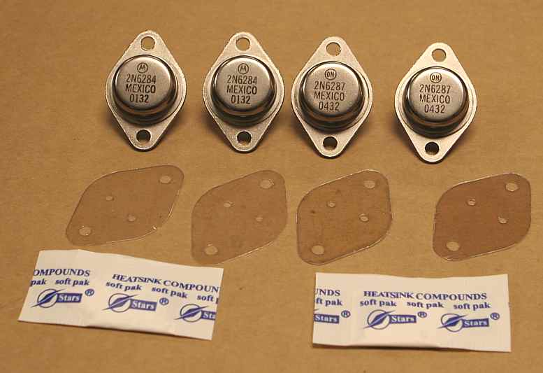

The problem I was having is the sound just stopped one day.So I replaced the volume pot,still the same.So I replaced the transistors on the amp.Now I have good sounding quality but the sound is stuck about half way and I cant change it.I tried a remote volume control and still cant change the volume.If I turn the volume knob up as far as it will go the sound goes up faintly.I am stuck

Which "transistors"--what did you use for a "replacement VC " ?

here is a pic on the transistors that I replaced on the amp

Your issue would not have been the transistors, I hope you did not buy these off of Ebay, if so Ron can tell a good story about some he bought, they were all duds.
