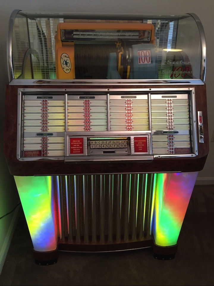

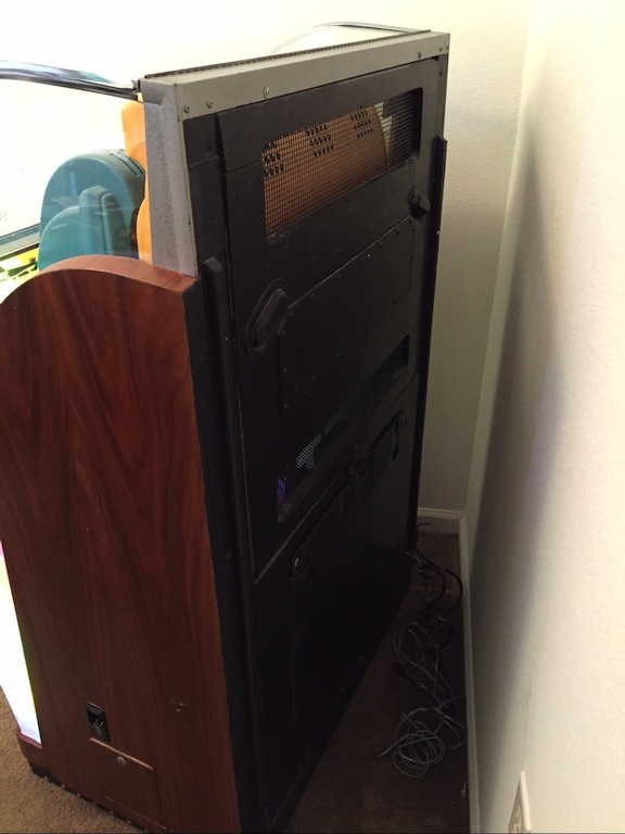

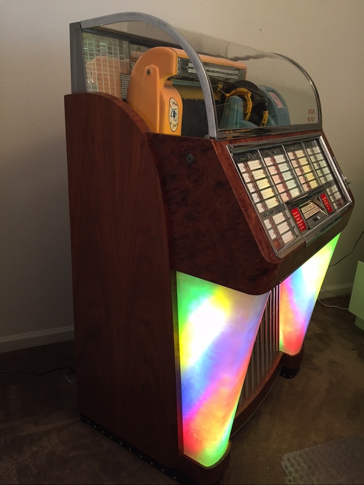

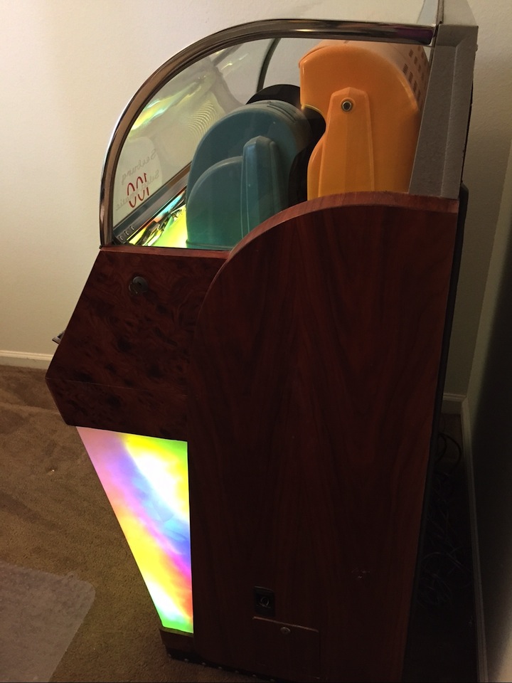

Hi all,
It seems I am fated not to pick up a project (will not bore everyone with details), however now a seller quite close has a Seeburg M100C. Given this is not a project, and way more than probably I was going to spend, I'd love to get ideas on a fair price.
I have included some photos, plus here are the details I know so far:
1. It works (I have a quick video of it playing, not sure I can load that here?) - although sounds like it is a little temperamental as seller said they were going to use a repair man but its now working. (The repair man put me on to it - he fixed my 1st pinball)
2. Repair man believes amp has been partly rebuilt - I assume I can check that when I view to see if there are old capacitors?
3. Repair man said he believes it has Pickering 340-D - does that add value? (in other words, I have no idea what this means :oops: )
I am going to view this week - from the photos it looks in very good condition cosmetically.
So, thoughts on fair price? And what thing should I ask/looks at/take photos?
Many thanks - I'm getting closer to owning my 1st one..its just a matter of time (and money, and a seller not messing me around :roll: )
Danny

Re: Price check and things to look for/ask on a Seeburg M100C
by Ron Rich » Tue Jul 14, 2015 4:58 am
Hi Max,
IMHO, this unit has been vastly re-furbished. Obvious, non correct color items, have been used--It's your decision If you like the colors/plating/painting, and chrome. As for the 345-03D--yep--it's there--how good the non-available needles are (repops are available, but, IMHO, they do not match the OEM's) , is a question, as is the "partly rebuilt" amplifier ( which model ?, by the way). Mechanically/electrically, I don't have enough info to access the value, but I see them going on ePay for between $3500, and $6500

Thanks, Ron
Being new to this, I did not realize some things are not per original spec - can you clarify for me what's been changed?
Also, when I view it tomorrow, are there any simple checks I can perform that can provide more info on the mechanics/theatricals?
Finally, I read everywhere to see if the capacitors have been replaced, but are they viewable without unscrewing things (given its in someone's house)
Many thanks again, Ron - anyone else have any thoughts on this box, value, etc?

by Rob-NYC » Tue Jul 14, 2015 2:26 pm
"MAx" the only way to inspect the amp and receiver is to open the backdoor and remove two or three butterfly nuts thta hold the rear plate. This takes only a second and frankly, if I am paying for a machine that is at least partially restored and priced so, I expect the right to look it over.
If all or most caps have been replaced the amp will frequently have orange, yellow or brown capacitors.
It will look something like this:
http://jukeboxwiz.com/tag/seeburg/ -though yours being mono will have fewer parts.
Since the seller claims that it is partially working (whatever that means) it should be safe enough to plug it in and see what does, or doesn't work.

Rob - I'll remove rear plate and check the amp. Plus there is a small video of it working here (that's all seller sent until I visit) https://www.youtube.com/watch?v=1RvYdEcUz0E so that's a step in the right direction.
Ron - If I purchase this, I think I will have to transport on its back as that's the only way it will go in my car. I will have to get more details on how to move this model - if and when I purchase. I'm not planning to purchase and move tomorrow, just view and then decide.
Ron/Rob, can you expand on what's not original from what you have seen..I don't mind if someone has, say, used a darker veneer, but would be interested in anything that in later life may devalue the machine.
Many thanks again!!
by Ron Rich » Tue Jul 14, 2015 7:50 pm
Hi Max,
I am not sure if he has "veneered" that cabinet, or just stripped it down to "wood" and re-stained it ? Colors are definitely different from original--Red coin, and info windows, are repros--I prefer the original, more maroon color, type. I don't recall what they were originally, but I think the color (red) "selection indicating" numbers were different on a C ? Check out the late, "Tony Miller's" web site (listed above), for an early artists conception of that model. Ron Rich
