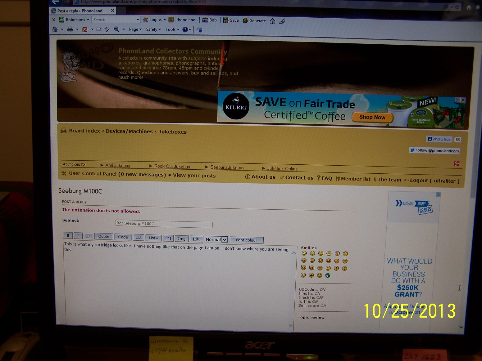

This is what my cartridge looks like and this is what I am seeing at the top of my page.

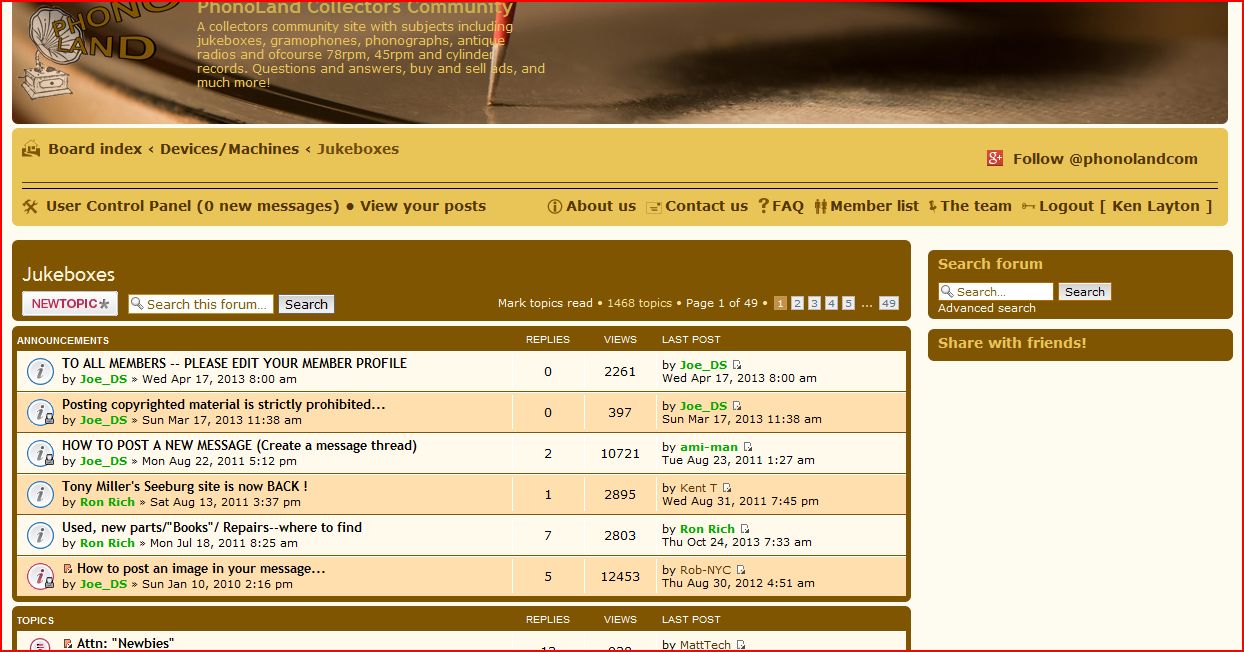

Here is what you should be seeing on the jukebox forum's index page.
phonoland index page.JPG (163.27 KiB) Viewed 996 times
Re: Seeburg M100C
by Ron Rich » Fri Oct 25, 2013 10:43 pm
Click on "Board index"--go to the jukebox section, and you will see it--
You have an aftermarket "Thorpe" cartridge in that phono-- Ron Rich

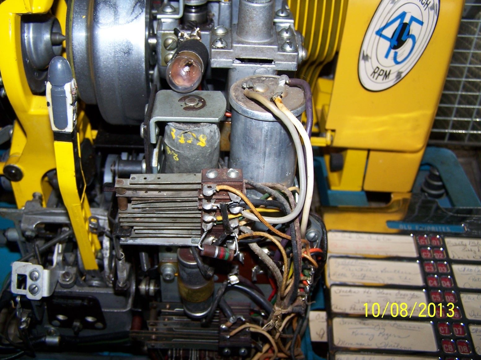

Hello, new to the forum, but wanted to get back to the wiring for the M100C motor start capacitor. Understood the wiring colors are not consistent. Not that I'm sure it helps, but the motor housing cover has "March 1952" stamped inside.
The wires leading to the old motor start capacitor are black, green, and what appears to be "off" yellow or faded orange. Not sure If the latter is really old, grimy, oil stained white. But, since I've seen references to yellow wires showing up in these, thought I'd throw the query here. 1.4 to ?, common to ?, and 1.0 to ?

by Ron Rich » Tue Nov 19, 2013 9:28 pm
According to the service manual (please see "Atten Newbies" above !!) the 1.4 goes to the "O" contact the C to the upper left motor contact on the four position "tie strip"--and the 1.0 goes to the upper right side of that same tie strip. Ron Rich
