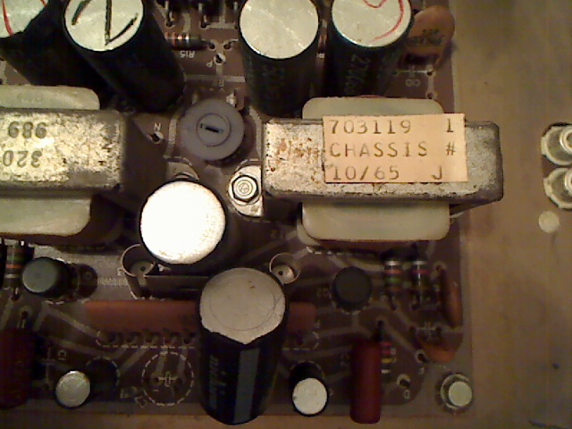

If you want to find the age of your unit remove the back. On the amp/receiver you should find a small white sticker that should give the date of manufacture:
example:
R202-02-10
Chassis
09/65 (September, 1965), of course, different dates.
Picture 27.jpg (105.48 KiB) Viewed 5734 times

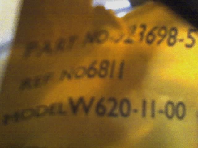

For the turntable
W620-01-01
Micro-Matic #2.jpg (24.6 KiB) Viewed 5734 times
