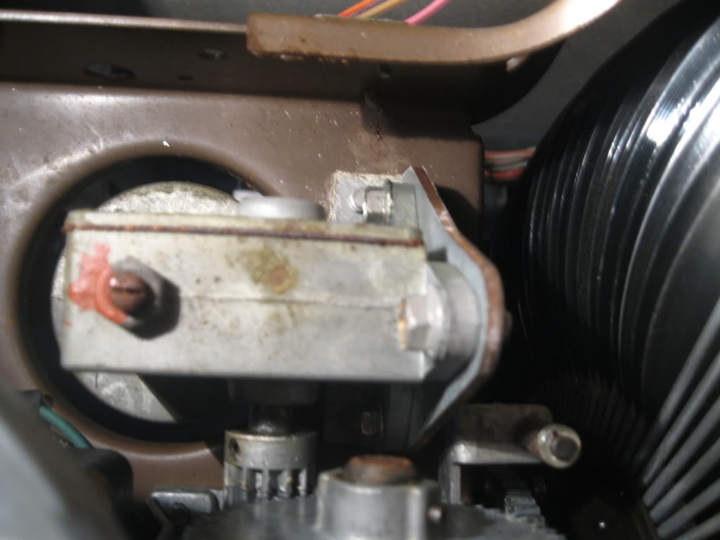

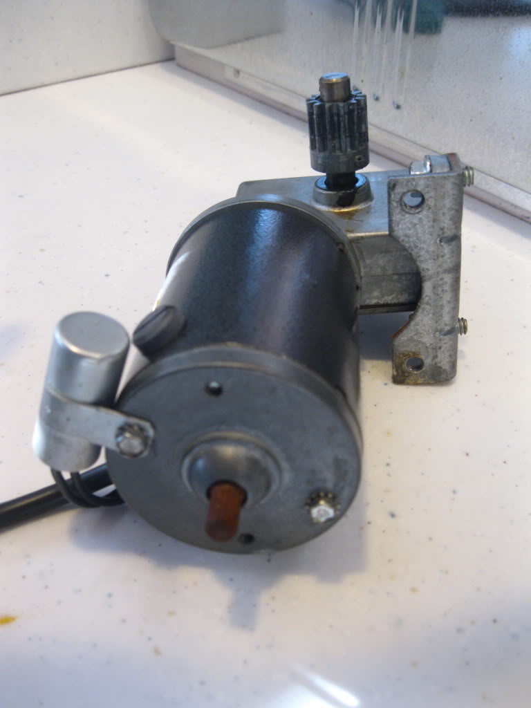

I removed the grabber motor.
I removed the two 3/8 bolts (parallel to the carousel) from underneath the unit. I also removed the 1/4 screw that holds the pot to the bottom of the motor, for maneuverability (this was probably not needed). I unplugged the electrical connector and lifted the unit out from the top.
Here is the motor (label reads: Volts 28 D Part number 5249)
I was able to rotate the bow off of the platter and up to the carousel. I was only able to do this by turning the cam gear in unison with the grabber arm and there was a good amount of resistance. (I think it is possible to over-rotate this assembly, which I accidentally did)
Questions:
1. If I put in a new fuse and put the selector on scan (with motor out and the bow over the carousel), would the carousel spin?
2. If this was a car motor (window, etc), I would put positive and negative power to the leads, then reverse the jumpers to make sure it moves in both directions. Can / Should something similar be done to check this motor while it is out?
3. What does the cog that sticks out of the bottom of the motor do?

by Ron Rich » Sun Jan 15, 2012 10:19 pm
1. Yes--if the gripper bow is down in the correct position above the basket, putting the service switch in "scan" should turn on the basket motor.
2. If there are only two leads to the motor, yes--if there are four, no--
3. "cog" ? --do you mean the "adjustment screw", that has the red glue on it to tell you not to "adjust", or "remove it" ? ---- If so, that was the (motor) factory's "thrust adjustment" screw--

Thanks for the help. I was referring to the shaft opposite the red pain nut.

Are you talking about the "knurled" shaft at the rear of the motor ? If so, it's there to turn the motor manually.
Basket only should "go" one way--side switch cam will prevent it from going in the 2nd direction, if "pushed", and you may cause problems there--
Motors are usually NOT identical. One (the gripper) usually has an oil hole drilled in it where the casting "flanges". They are both 28VDC
