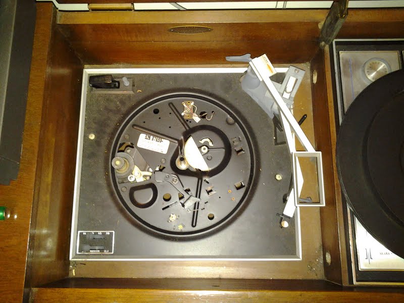

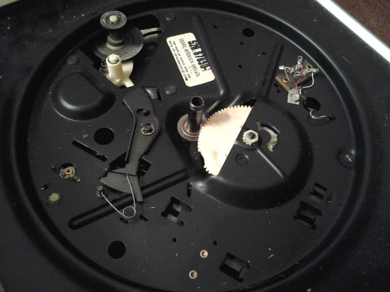

by Blu3tongue » Sat Oct 13, 2012 12:55 am
Sorry, I'm a little late. I work 48 hours a week and I go to school in the mornings, so I forget sometimes. BUT I have a day off on Monday from school and work, so it's my plan to tinker with this thing, and I'm looking forward to it.
So here are the pics; let me know if these aren't what you're looking for.
-Sam

by Blu3tongue » Sat Oct 13, 2012 12:58 am
Also, notice in the second picture that gap you called the "change cycle release position," does that look as it should?

by MattTech » Sat Oct 13, 2012 2:19 am
There is no real way to determine the condition of a record changer by online photos.
Binding, bent, or damaged parts are imposible to determine.
It's really got to be on a tech's bench to see what is up with things.
As for the cycle gear, the toothless gap should be directly facing the platter spindle - the neutral position.

by Rob-NYC » Sat Oct 13, 2012 7:18 am
What is happening here looks pretty common with these old changers. The position of the white gear shows that is has begun the changing/arm return cycle. When this happens a mechanical load is placed on the turntable motor and if the rubber idler puck is oily, or hardened to the point where it won't grip the inner rim of the platter it slips and things come to a halt.
As it is, try turning the white gear -counterclockwise- the way the turntable gear would till you get the gear to come all the way around and back to the cutout (at rest) portion.
You might try first cleaning the rubber puck surfaces with a rough cloth and water. Rubbing alcohol can be used to remove oil and grime on both rubber and the inside of the platter -but use it sparingly as it can further dry out the rubber.
If it still slips to the point of stopping you can remove the puck and try roughing it up a bit with a piece emery board, a fine file or fine sandpaper. Use a moist cloth to remove any left over grit and don't over do it. the idea here is to just remove a glazed or dried out and hardened surface and restore a better grip. You must be doubly careful in this case since the are two pucks involved and reducing the size of either or both will cause slower rotation.
There are rubber rejuvenating liquids and "non slip" treatments that can help old rubber last a while longer. Look up "phono non slip" by GC Electronics.
If you feel up to it, try removing the entire changer so that you can add a --drop-- of oil to the top and bottom motor shafts. A few drops on the center turntable shaft is also indicated and one on the idler puck shaft. Be sure to wipe away any excess so that it doesn't contaminate rubber surfaces.
Most other surfaces inside a changer should remain clean and dry, however the main cam connected to that gear may have a synthetic lube on it, such as Lithium grease and if that is dried out adding new, similar grease will help things run smoothly.
The general rule here is: if it ain't oiled -don't oil it.---And don't force anything!
