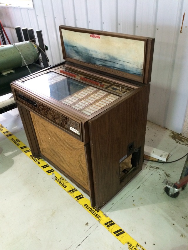

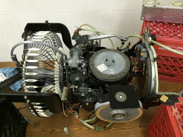

I recently picked up a non-working rockola 461 for cheap and was able to get it working fairly easily , I thinks that grab arm was in a bind from being transported on its back by previous owner.
My goal for this is to be a usable jukebox that I would not be embarrassed to have in my house. It came very dirty and I think that a family of mice used it as a home for a long time.
Like I said it is working now and it sounds ok, and I have lubed the areas I can see obviously need it but I am worried about oiling where I should not.

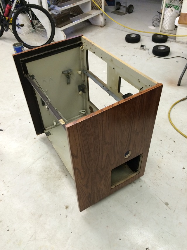

I can see I will have to make some repairs to the cabinet (water damage on the base) and will have to remove everything from it to do that easier.
So I my questions are should I dissemble the mechanism to clean it or can I do an adequate job cleaning while it is still assembled? While searching this machine and other Rockola's I have seen mention of a lubrication guide but I can not find a copy of it anywhere, I have the manuals but it does not include this information or any user guide type info at all really.
With the sound system will it require any servicing such as recapping or should I just leave it alone because it it currently working?
My main worry is that I am going to take a working jukebox and turn it into a non-working jukebox :shock: .
Thanks for your help,
Shawn
Here is a link to the mec working: https://youtu.be/cDyLesDa6gs (I have cleaned contacts on read-out arm so it does not shutter when returning home any longer)

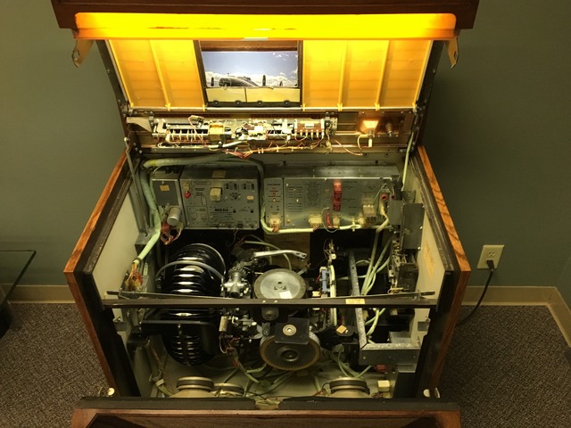

I took out center plastic section so that the internals would be visible.
Image Image

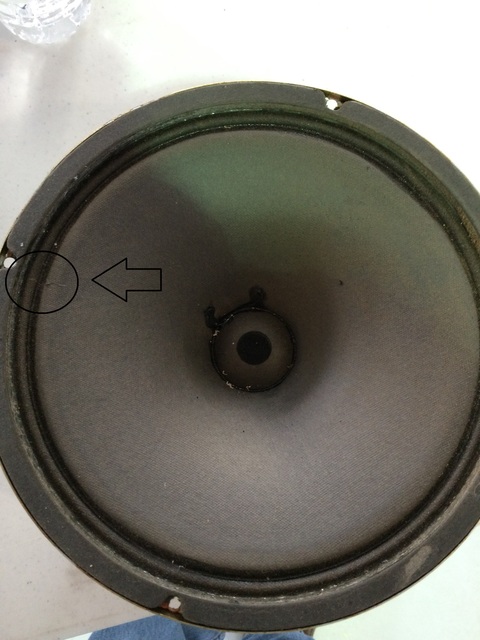

Ok, so I am almost done with my restore but while inspecting the speakers I managed to put my thumb thru one of the woofer cones :evil:.
I am now looking for a replacement set, what should I look for as far as pairing them with the amp?

Wow, that is some great advice Here is a pic of the speaker in question. Do you think it can be patched?
I will diffidently try your suggestions, do you have any tips for adding crossover and tweeter? I am not very electronic savvy yet.

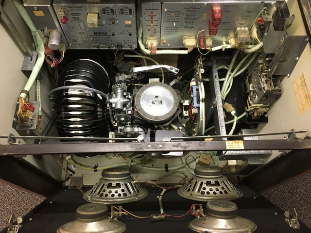

Here are some pics of my progress so far.
Image Image

Very easily salvaged--a tube of "Testors airplane glue", with or without, a small section of TP--and away you go--Ron Rich

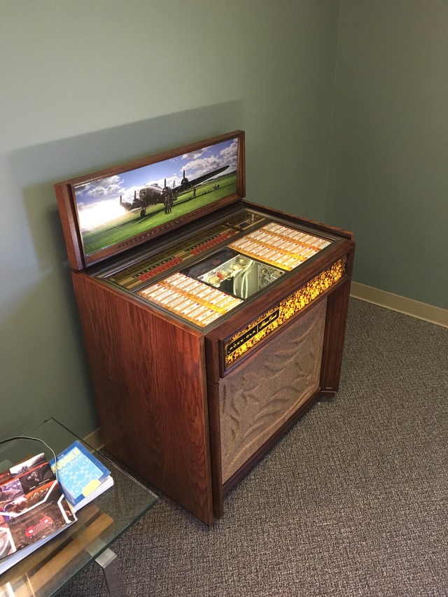

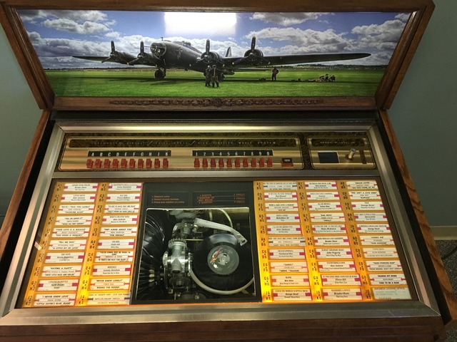

Finally got it done, I could not be happier!!!
I can switch out the pictures, change the look, It is located at an airport right now so that is why all the pics are aviation related.
Thank you everyone for your help!!!
