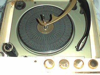

I am looking for an owners and a service manual for this unit. I also need one that covers the collaro changer. On the 78 and 45 speed the tone arm misses the record. Can anyone tell me where the adjustment for that is? Thanks Donn

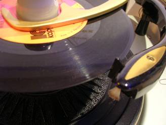

3. Make sure the tonearm tip is properly touching the record edge during the size scan (models after 1957). If the overarm is bent, the tonearm height is misadjusted, or the records are not level, the scan will fail to find the right size. This picture shows correct scan operation:

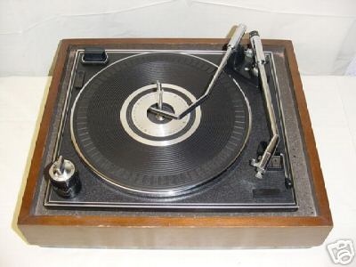

On the changer pictured below, the setdown adjustment is reached through a hole in the turntable. Lift the edge of the rubber turntable pad, look for the hole, and rotate the turntable so the hole is near the back end of the pickup arm. You will find a large slotted screw head on an eccentric adjustment. Since this is mounted on the change cycle cam, the adjustment must be made when the changer is out of cycle.

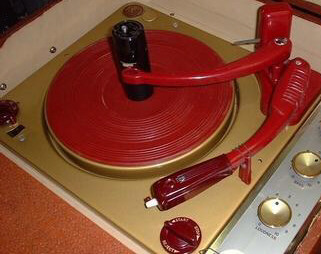

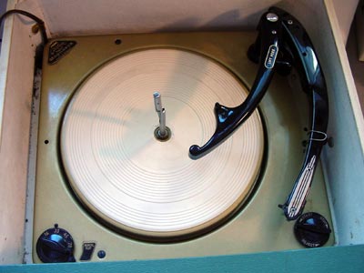

On the next changers pictured, the adjustment is the screw slot in the hole in the plinth between the tonearm shaft and the tonearm rest post. You can see it in the second picture, under and to the right of the pickup arm:

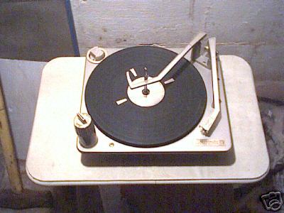

On changers newer than 1967, the adjustment screw is on the right side of the tonearm, behind the hinge. Do not change the screws that point down. This should help you find it:
