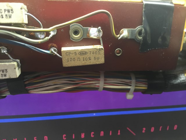

by coldshowerkid » Sat Oct 31, 2015 7:56 pm
Hi Ron
I have found a hot running item. no freeze spray yet so unable to test. but I think I owe you a big thanks

by coldshowerkid » Sat Oct 31, 2015 8:09 pm
IMG_0238 (640x480).jpg (59.35 KiB) Viewed 498 times
Re: selection problem Rockola 453
by Ron Rich » Sat Oct 31, 2015 8:26 pm
Do NOT use freeze spray on this type resistor--it's a "sand-block" and supposed to run very hot--what I was referring to are the small components inside some type of container, or point to point wiring. Ron Rich

ooh lucky I posted a reply. think I need to find an expert to give it the once over. thanks again Ron

As Ron said those resistors are supposed to get warm, you need to explore in the control circuit, sadly I have not touched Rock Ola jukeboxes for the best part of 30 years, ask me about a Rowe Ami then I am your man.
