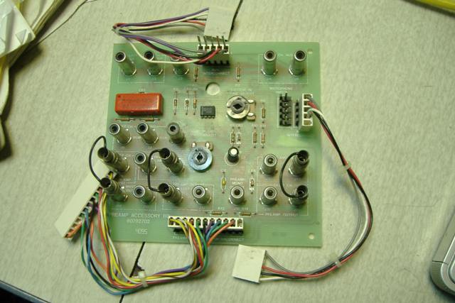

Picture of amplifier accessory kit # 26694703 for the R91 through CD100-C jukes.
26694703 kit.JPG (44.23 KiB) Viewed 1385 times

This one won't work ! You need a WP-100 type. Ron Rich

Yes, that's right, Ron. I was only using this picture of the 26694703 kit as an example since I don't have any pictures of the 26694704 kit.
The 26694704 kit has a slightly different board, different mounting setup, longer cables, and different instructions.
26694704 is for the WP-100 (Berkely, Storm, etc) wall mount jukes.
26694703 is for the R91 through CD100 series with the 250 watt amplifier.
