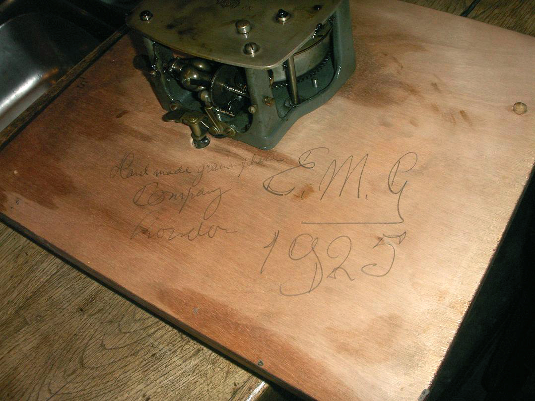

I sold my EMG oversize to a happy German collector.
Now I stumbled upon a Mark 9 emg with mark 8 (straight horn) emg.
Again I fit a 5b soundbox to it and I couldn't believe my ears...
The quality of soundreproduction is so pleasing to me,I went over all of my favorite 78rpm electric recordings.
I believe that the straight horn design was actually the best way to go...
The bass reproduction is more or less the same as the oversize.
I know it's hard to believe,but maybe there's even a difference in the way each horn was made.
Maybe they used more layers of papiermaché in the early machines.
Can anyone tell me by looking at the signature on the photo of the wooden board of my emg if this is the
signature of EMGinn himself? Did emg already exist as a 'company' in 1925 ?
Was the mark 9 already produced in 1925?
