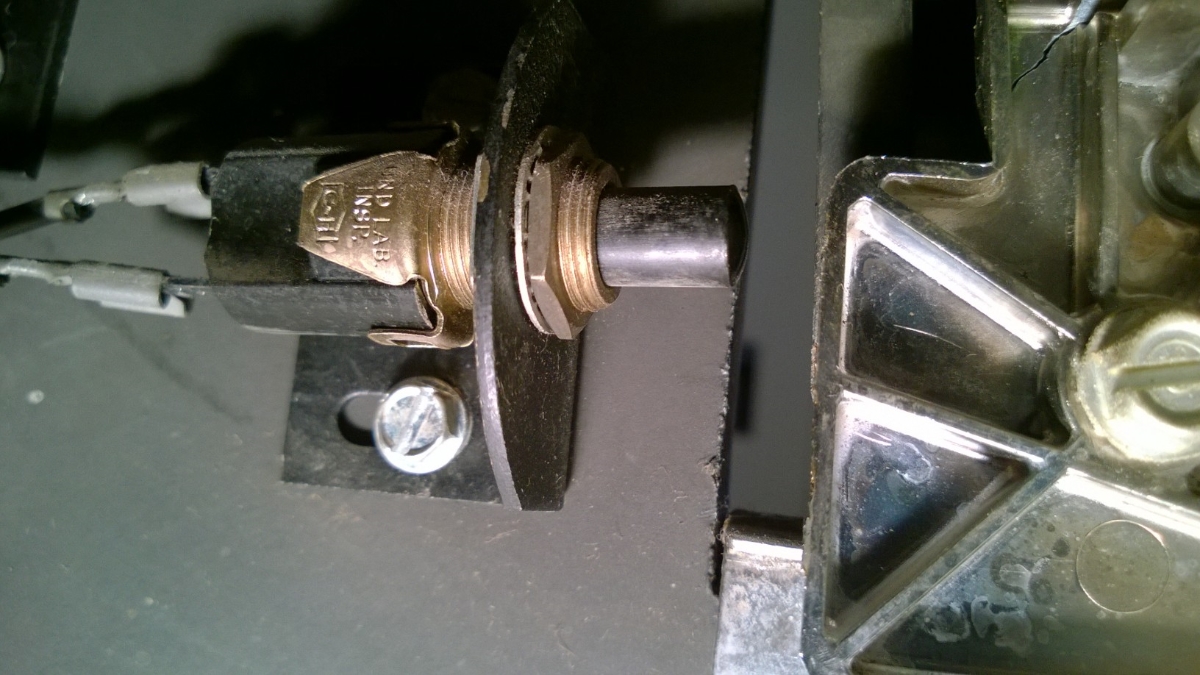

I'll be ordering the full manual set so I can figure out everything else; pricing units setting, etc. but I am curious about one button. It's located on the right side under the main display panel. It doesn't make contact with the hinge closed (it looks like it's supposed to but I'm not sure) and with the panel in the up position, pressing the button doesn't seem to have any effect on anything. See the attached photos.
What's it for?
Jack
Re: Bought my first Jukebox! Seeburg SS160.
by Rob-NYC » Mon May 11, 2015 6:36 am
Jack, that switch controlled a light in the mech compartment to aid servicing. It should be opened by closing the top door...just like a refrigerator light.
Look around there should be a couple of sockets connected to it. 'Been a long time since I've seen that switch.

Rob is correct--that switch turns on two (#51 -I think ?) lamps that are over the pop meter so that the person changing records can view it--But, due to the defect in the lids, causing it not to close fully, they usually burn out, and no one replaces them, as you can easily snap off the "selection now playing indicator", and view the pop meter-- Ron Rich

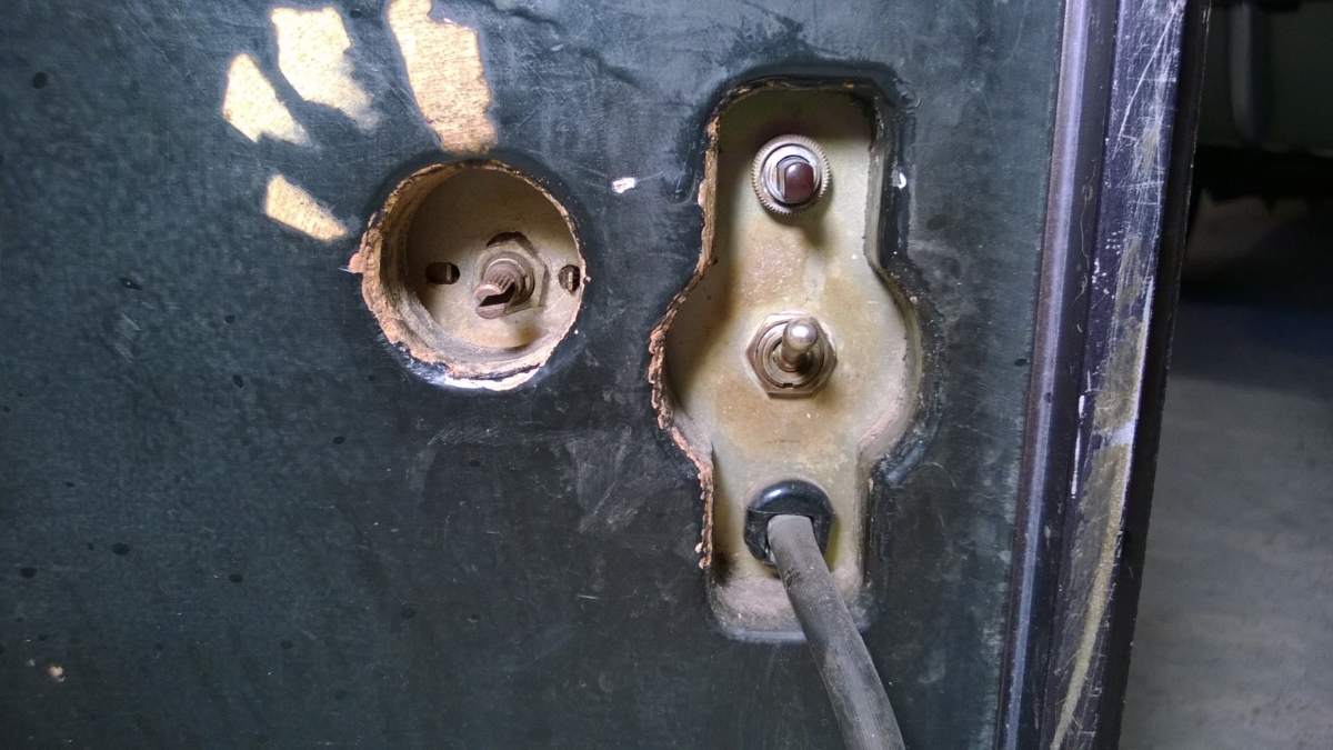

How sensitive are these units to cold? Since I recapped the auto-speed unit, it works but needs about 10 - 15 mins of VERY slow playing until it seems to "warms up". Doesn't matter whether its playing a 45 or a 33 1/3. It's in my garage in Canada and the average temp in there right now is about 48F to 53F. I've read they like 65F and above. Still an auto-speed issue or just temp?
Also, while I was exploring the bottom cabinet, I noticed that the reset button (I'm assuming) above the power toggle is not hooked up to anything inside the cabinet. Just two wires hanging there. What are they supposed to be connect to? Somewhere on the amp (it's near that section) or somewhere else?

The two wires connect that optional slide switch on the outside rear of the phono. They connect to the "black" and "white" terminals on the amp, near the volume control, IF, you want that slide switch to function as a record reject switch. Ron Rich

by LAZERSNAKE » Mon May 18, 2015 11:58 pm
Hi Ron,
I followed your instructions in your manual for cleaning the motor, did the trick! It wasn't too bad for build-up but it made a difference. The coupler was a little loose also. The top two Allen key screws could have been a little tighter, they're good now.
I'm missing rubber bumper underneath the motor. I'll have to get one of those.
I also re-aligned the service light switch on the right side of the jukebox and replaced the two small bulbs (#53) over the pop meter. They work! The record selector light now work on the "A" side. The fuse was fine but the upper light bulb was burnt out, switched them and the top on works. I'm assuming replacing the lower one will do the get it going.
Hooked up the two wires from the reset button on the back of the unit to the black and white screws on the amp, resets when pressed.
