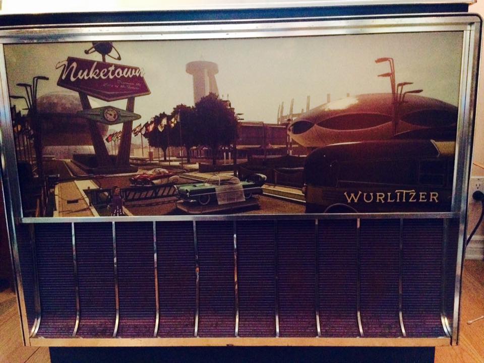

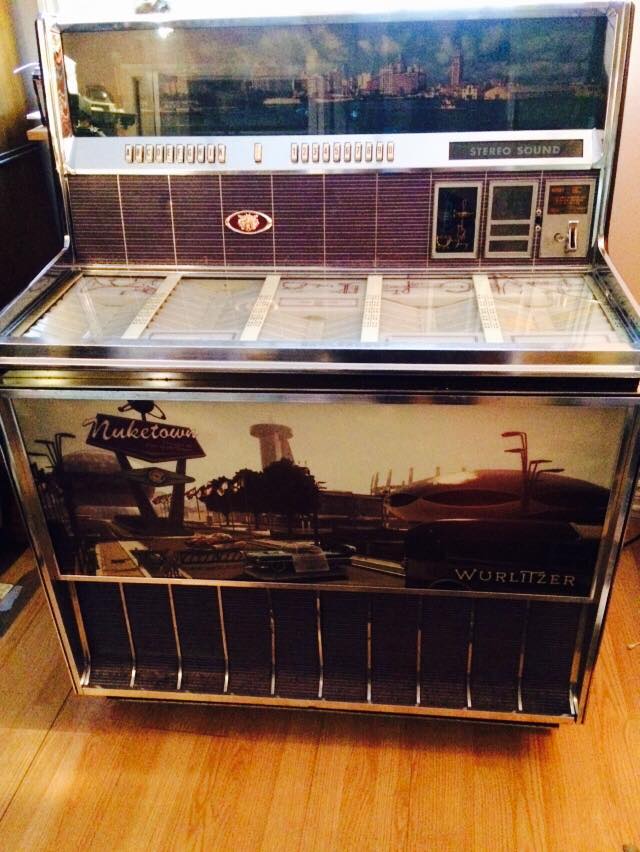

Thought I would share my final results with you as, yes, I kinda miss you :) and the fact that it is working as it should in great part thanks to you :) I used an image of a video game I worked on for many years to personalize it even more since the original front glass is too costly and since I thought the space age look of it fitted perfectly with the Wurlitzer 3310
Thank you guys !
Re: A newbie's tale on trying to get a Wurlitzer 3310 to work...
by Ron Rich » Sun Mar 20, 2016 6:23 pm
Hi Julie,
Glad you got it running !! Looks fine to me ! Enjoy ! Ron Rich
