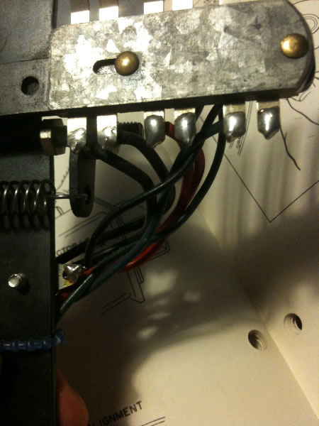

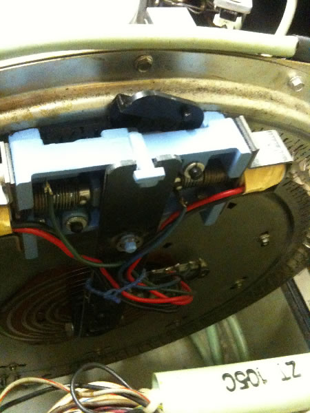

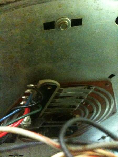

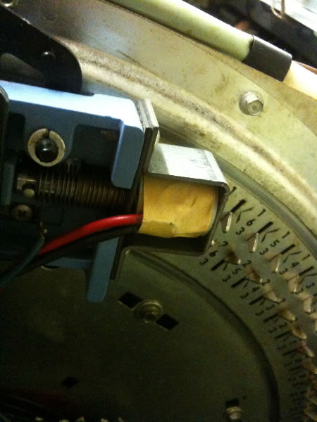

i can see that all the hammers are there, but it doesn't seem to be firing on the read out side.
is it supposed to fire when the song starts playing or when it's over?
i have included some photos of the apparatus to see if anyone can tell if something is amiss here.
when a selection is playing, i can touch the hammer with my finger and it resets the selection, so it is physically capable of doing it, just not sure if it's set up correctly.

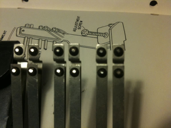

i checked all the slip-rings and they appear to be making contact, except the two innermost, which have black wires. i didn't try the DeOxIt yet since they all seemed to have contact.
the outermost wiper with a black wire started rotating the carriage when i touched the slip-ring and the wiper at the same time.
i cleaned the brass piece that touches the connector that touches the switch for the selection. it was pretty dirty and i hoped that would solve it, but no luck. this is the piece that is attached directly to the blue and green wires. my gut is telling me the problem is between this or the coil.
the wipers seemed a little uneven, but they all seemed to make contact.

You can not "see" if a contact is making GOOD contact on the slip rings--you must use the meter--the same as above--touch the two leads together, and see what it reads, then touch the slip ring with one lead and the contact blade that should be contacting it --up where the wires are soldered. If "good", it will read the same as when you touched the leads together--

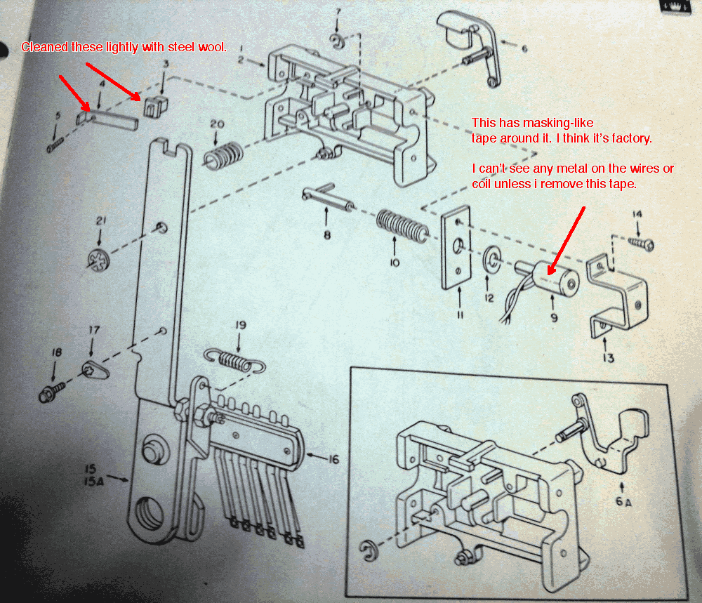

I sure do not know what you mean by the "brass piece that touches the connector--------"that you "cleaned" (how?)--
And "tape"--why is tape on those wires ? Did someone change that coil in the past, All wires should be soldered to a connector-- --just remove it, you can always put new on, if needed---

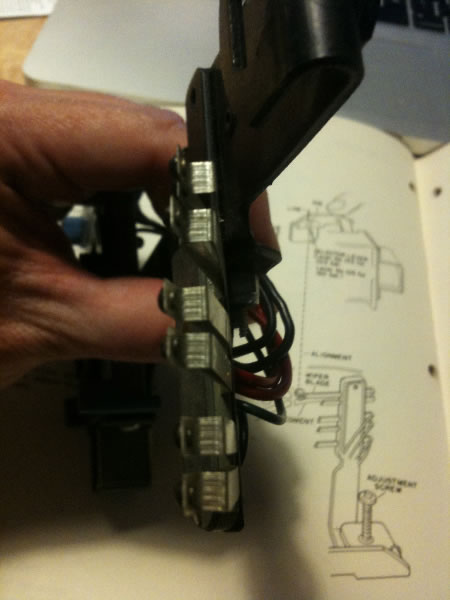

i have attached an image showing you what i cleaned. it's from the parts catalog diagram of the read-out carriage.
the tape i mentioned is wrapped around all the coils and it looks like it is factory. it's a paper based tape.
the only thing i was really not able to confirm is if the coil is working, as i don't know where to place the pins from the ohm meter to see if it is making contact.
all the solders look good to me.

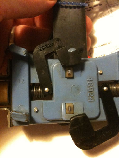

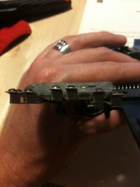

i have also included some other photos as well.

Do NOT remove the tape around the coil body !! That is "factory applied" -- I wrongly assumed you had tape on the wire leads coming out of the coils----follow the two wires down to the ( soldered) connection points on the contact blades--
Also--NEVER use "steel wool" ANYWHERE near a jukebox--or anything else "electrical", as it WILL short something out !

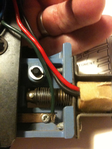

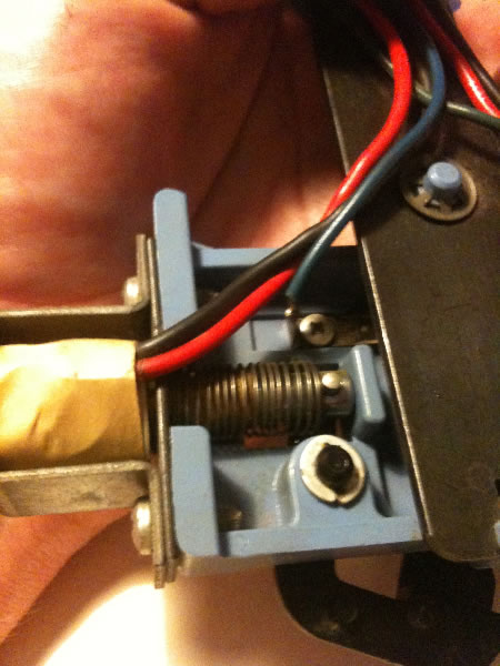

ron, i tested the coil to the solder on the wiper arms and it was a-ok for the B side, but for the A-side, it was sort of hit or miss.
i had to get the ohm meter tester inside the tape and it worked sometimes, but others not. i fear that the wires inside may've come loose at some point.
i peeled back the tape just enough to see what was happening and it "appears" that the red wire may've come loose from the tiny green wire inside the tape that surrounds the coil. i wrapped it back together tightly with another piece of wire and taped it back up, but the same results.
i wonder, do the red and black wires that lead into the coil need to remain separate or be touching?
i would assume they need to NOT touch, but i can't really tell unless i remove the tape from the good coil, which i don't want to do.
