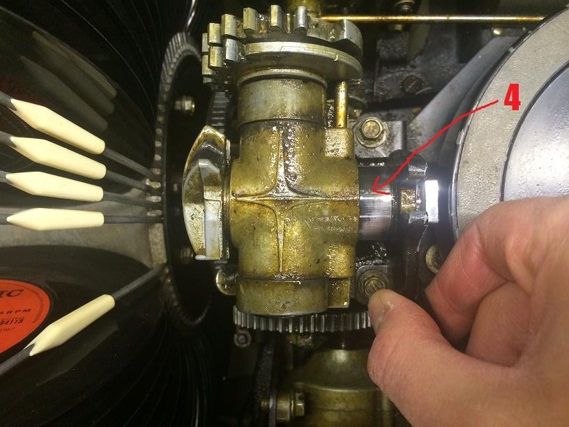

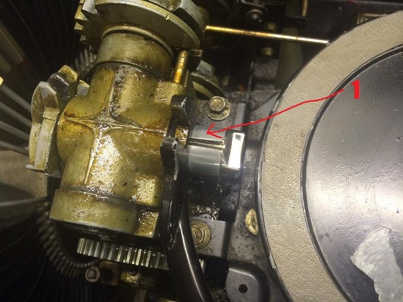

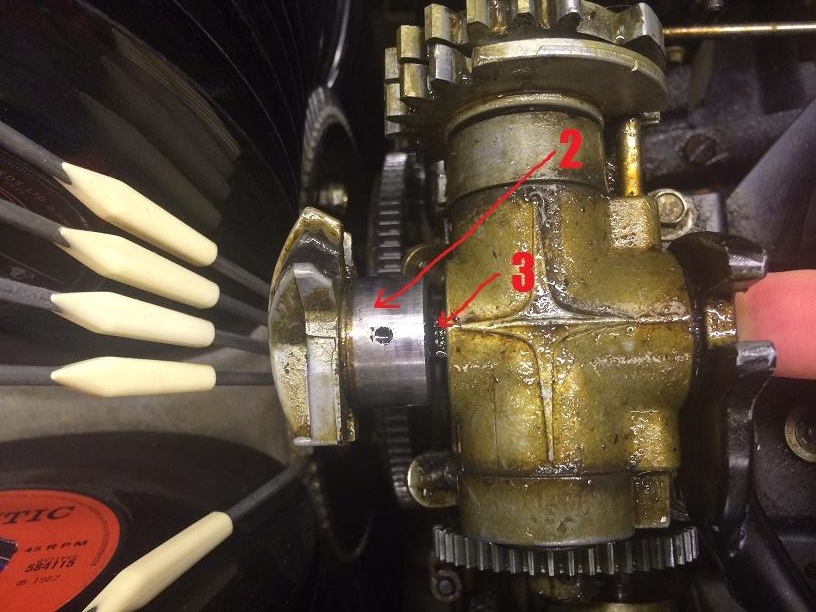

Just so I have this correct I've uploaded a few pictures to make sure I know the terminology:
1 is the inner "smaller" gripper right? This is the part I push in?
2 is the gripper "bow", with the bow shape to the left? 3 being the "inner" part?
4 is the "outside" gripper section?
If I have this all correct I just keep oiling with 3 in 1 motor oil? As it is the center part that pushes in moves freely and springs back, not sure how "smooth" it needs to be. It may catch ever so slightly on something inside, but doesnt appear to make too much difference.
Thanks for your help Ron,
Adam
Re: Basket Problem
by Ron Rich » Fri Jun 06, 2014 1:38 am
The number 1 red arrow is pointing to what I called the "inner", and just past the arrow, the black painted part of the griper arm is what I called the "outer"--these must slide freely, and independently--- Ron Rich
