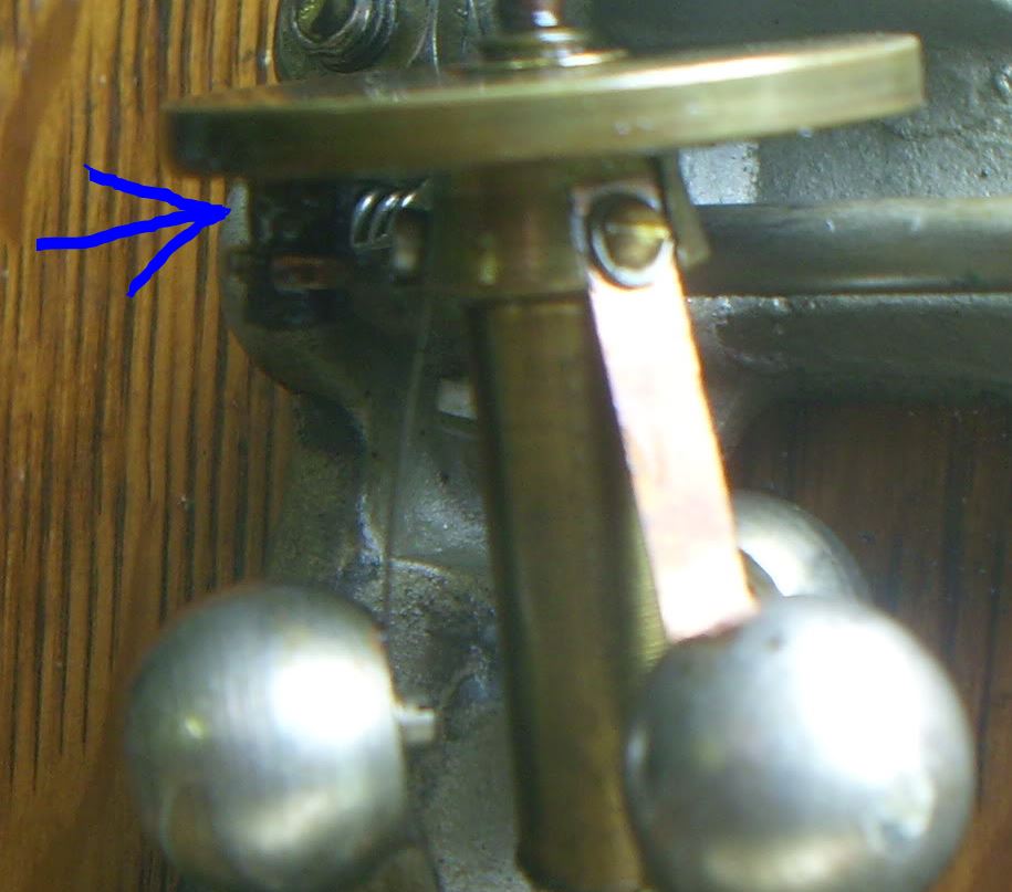

It it's a harsh vibrating sound, that may be caused by the governor, which you can check out in the Compleat Talking Machine. Oftentimes, all it takes to fix it is to put a few drops of quality oil onto the friction leather foot that interacts with the governor's flat disc.
This is from a Victrola, but nearly all wind up phonograph motors have something similar:
governor foot.JPG (76.44 KiB) Viewed 3586 times
__CLICK IMAGE TO MAKE IT FULL SIZE__
I normally use standard car transmission fluid to lubricate the governor's friction leather foot. If the leather is hard, a small dab of Vaseline will also work.
If it's not that, then it's possible that one of the governor weight's flat springs has broken or detached, or come loose. If all three springs are attached, make sure that the small screws holding them in place are tight. If it seems to be some other issue, definitely take it back to the repair man.

I'm back in business!
--> It wasn't the brake (all was well there).
--> It still made the noise w/ and w/o the plate.
--> I had to take the top off to take a peek. I spotted the issue right away. There was still some caked-on, dried-on left over grease on the gears for the governor. It was rather dark in the workshop on Monday (VERY hard to see). No wonder I missed that! I just took a dental pick and plucked the junk out of there and gave it a light oiling. TAH-DAH! That seemed to be it! I played 5 records last night and everything worked and sounded PERFECT!!
Thanks for allowing me to work out my issues (and report them) here! It really helped. I hope that this was the issue and it doesn't growl at me again! *laugh*
