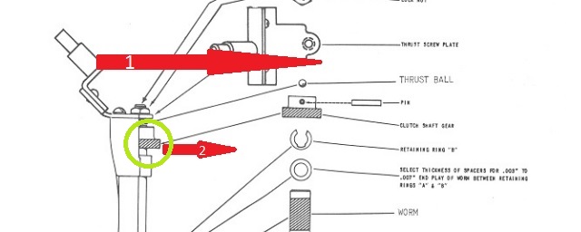

i understand it's difficult to understand my explanation, I'll try to explain it with an image.
I pull on the piece of metal that is connected to the clutch (arrow 1), in that way, the gear seen on the image gets closer to the other gear that is not seen on this image (arrow 2). Then the two gears touch each other and the mechanism starts to scan.

It is my guess that the 4 screws that attach the clutch housing, to the main carriage casting, are loose(missing ?)--at least the top two are--no other way this can happen, that I know of-- Ron Rich

Gill, I agree with Ron that a loose clutch is suspected here. Here are two Seeburg clutch assemblies:
http://s1192.photobucket.com/user/Rob-N ... rt=2&o=166
The four mounting holes are clearly visible at top and bottom.

I've been able to solve the scanning problem (it were indeed those two upper screws who were missing), thank you guys so much for helping me, my jukebox can scan again!
