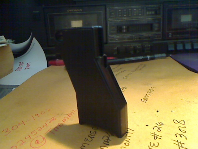

Are you talking about one of those flat adapters? If that stablizer arm is bent, as MattTech mentioned, your stack of records could be tilted, causing the whole stack to drop. --BB
Picture 42.jpg (82.85 KiB) Viewed 1182 times

Yes it is a flat adapter with the hole on the left top side of it.

With those flat 45 adaptors, my advice is to get spiders and put them in the center holes. The only time I do not recommend this is with the Micro-Mini series with the forked overarm, like the W712. The speed and size index are wrong if the large hole is not present.
Those spindles suffer from too many troubles, including:
- Warped records slip past the record guide (the part that holds the second record back).
- The center hole at the bottom of the flat spindle is enlarged, letting it wobble.
- The large hole spindle is not fully engaged onto the small hole spindle. A turntable mat can prevent this.
- A slight bend in the small hole spindle is a serious misalignment when the large hole spindle is used.
- The small hole spindle is not securely locked, or the locking device is bent, letting the large hole spindle wobble.
- The record guide on the large hole spindle (assuming it has one) is stuck in a high position, letting more than one record drop.
- The overarm is slightly bent. This does not affect small hole operation at all.
- The flat spindle is warped slightly, letting records slip past the guide.
- On the W712, the overarm pantograph links are bent.
They were made with one purpose in mind: Save money. The guy at BSR who made the first one should have been shot before he made it.
