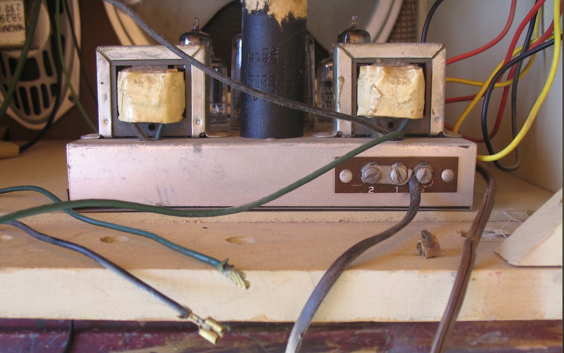

Hello,
I recently purchased a matching set of Magnavox speakers and record player. All looks to be good but there are two wires with push-on terminals coming from one of the transformers that I'm having trouble finding where to connect them. I believe they are used to power the phono motor.
Screen Shot 2014-05-03 at 10.59.33 AM copy.jpg (185.03 KiB) Viewed 534 times

by Thom » Tue May 06, 2014 6:01 pm
I wouldn't do that. They look like audio transformers to me and thus should be connected to speakers, not a motor.
Re: Magnavox 1SP263F Wire Hook-up
by Record-changer » Sat May 10, 2014 12:36 am
I have a similar amp.
The three screws are the speaker outputs. If you have only one speaker, connect it to the 1 and blank terminals, and leave the jumper in place. If you have two speakers for stereo, remove the jumper, connect one speaker to the 1 and blank screws, and connect the other speaker to the 2 and blank screws.
The power for the changer motor is a 3 or 4 pin rectangular connector similar to a Molex connector, but using square pins. On mine, there are three wires from the changer:
Black: hot from line plug to switch
Yellow: power for the amp from the power switch
Red: neutral from line plug to the the motor
