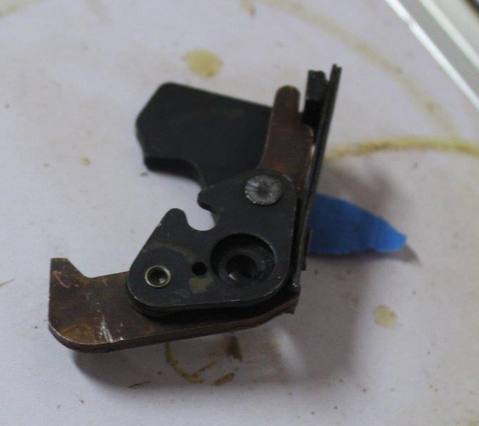

Given the issues with the part numbers, I thought a picture might be helpful. The hole in the center is where the screw goes, allowing the component to pivot. Above that hole is the horseshoe shaped hole that would seem to be there for a reason, perhaps on another post?

by Rob-NYC » Wed Nov 26, 2014 8:27 pm
Brooks, here are two scans from the original shop manuals:
http://s1192.photobucket.com/user/Rob-N ... ort=2&o=92
http://s1192.photobucket.com/user/Rob-N ... ort=2&o=93 Hover mouse over pic and click the fourth gray button to enlarge or scroll down to "download".
You'll see reference to a spring on the "friction drive gear" which is actually a metal strap around the main shaft. When the motor reverses the strap jogs the pawl assembly to engage with the driven (large) gear and initiate record handling.
If the spring is there and nothing else appear missing, the usual cause is just gummy old oil turned to molasses. Using a heat gun to free it up and adding new, lighter oil to dissolve the old followed by 20wt after the mech has been working a day or so will often clean up the problem
This sort of thing is why I always partially disassembled mechanisms and washed them with diluted floor stripper and hot water. A lot of these problems "go down the drain" that way.

Many thanks to Rob as everything seems to be working. I did have one other issue, so to close this thread out in case someone else experiences the same problem:
After heating up and cleaning out, the mechanism still worked intermittently. Both the friction gear and pawl assemble moved freely, but the pawl did not catch as it should. The friction gear has three tabs on it. Two are used to hold the spring. The third, which is 180 degrees from the other two should be positioned into the horseshoe cutout of the pawl. In the post with the picture, I speculated that a post of some sort may go into that area. After cleaning up and positioning the tab on the friction gear into the horseshoe opening, all appears to be working as it should (knock on wood...and by all, of course, I mean this issue, on to the next one I go)
