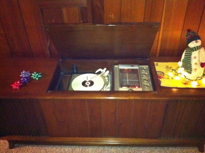

I recently purchased a PB RPC-39 with a Garrard AT6 turntable. I'm having some trouble with playing albums.
Specifically, the unit came with what I believe to be the original cartridge, a Sonotone 22T (ceramic, I believe) and a needle (I have purchased a new needle, as well). When I place the stylus on the album it does not produce sound, and it also seems to be resting too much on the stylus, so much so that the front edge of the clip on the tone arm for the cartridge is scraping along the album. I believe the balance needs to be adjusted, but I'm not entirely sure how to do that and wanted to ask folks' opinions before messing with it. I have no real experience with older phonographs (except, of course, from when I was a kid and they were new!). Any ideas you might have would be most appreciated! I am posting the one photo I have of the unit, but can take more detailed pics of the arm, cartridge, etc., if that would be helpful.

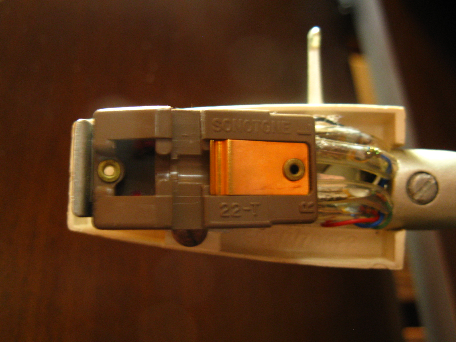

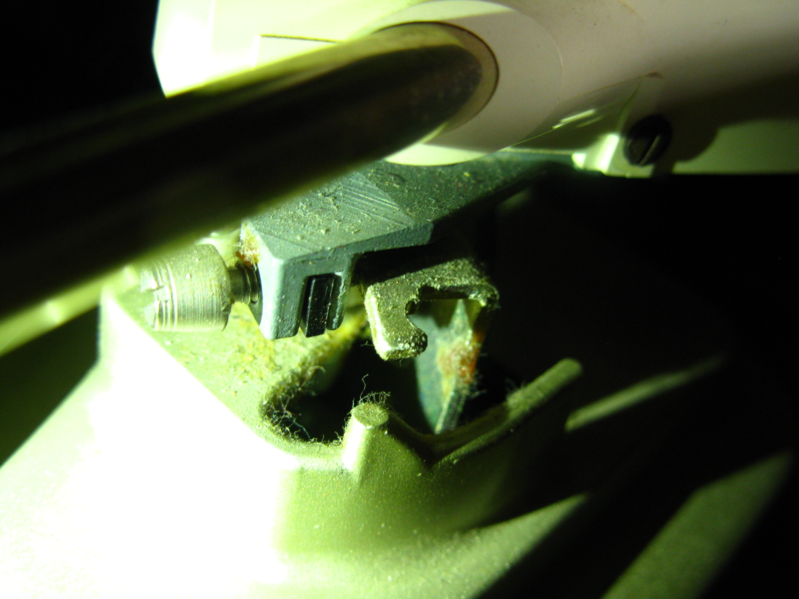

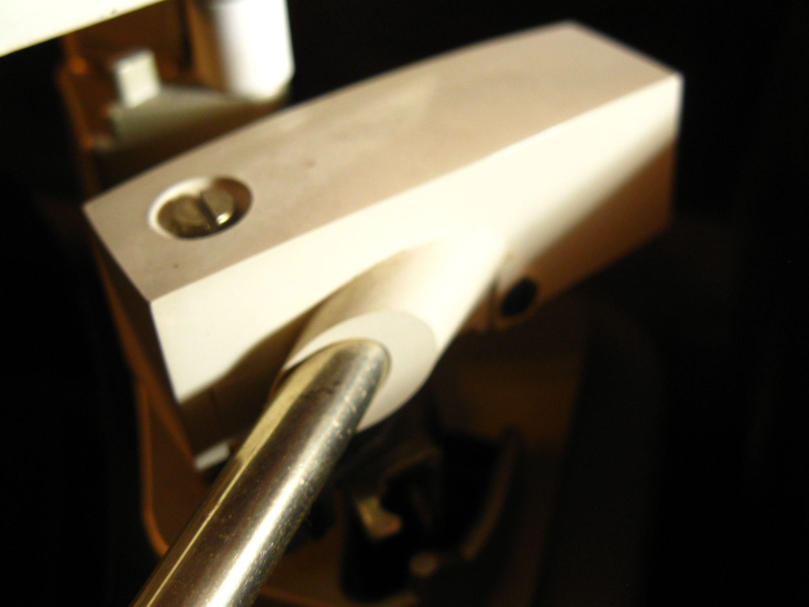

Here are several views I took close up. You'll see how the head of the arm, with the cartridge is resting solidly on the album, scraping along it. Also, even if I tried to manually hold it up some so just the needle is in contact I don't get any sound coming out, although I can tell that the unit is picking up my hand movements on the tone arm itself. Again, I apologize, I have no idea what I'm doing and do not know all the proper names for the various parts. Thanks again!

Not sure what this part of the tone arm is called, but you do... :-)
(556.81 KiB) Not downloaded yet

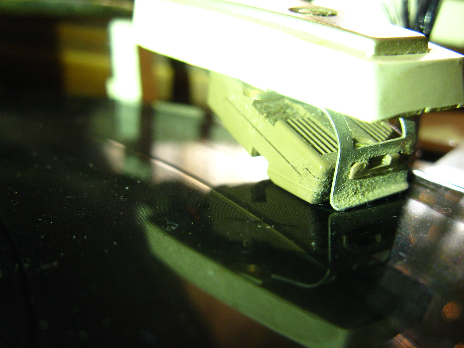

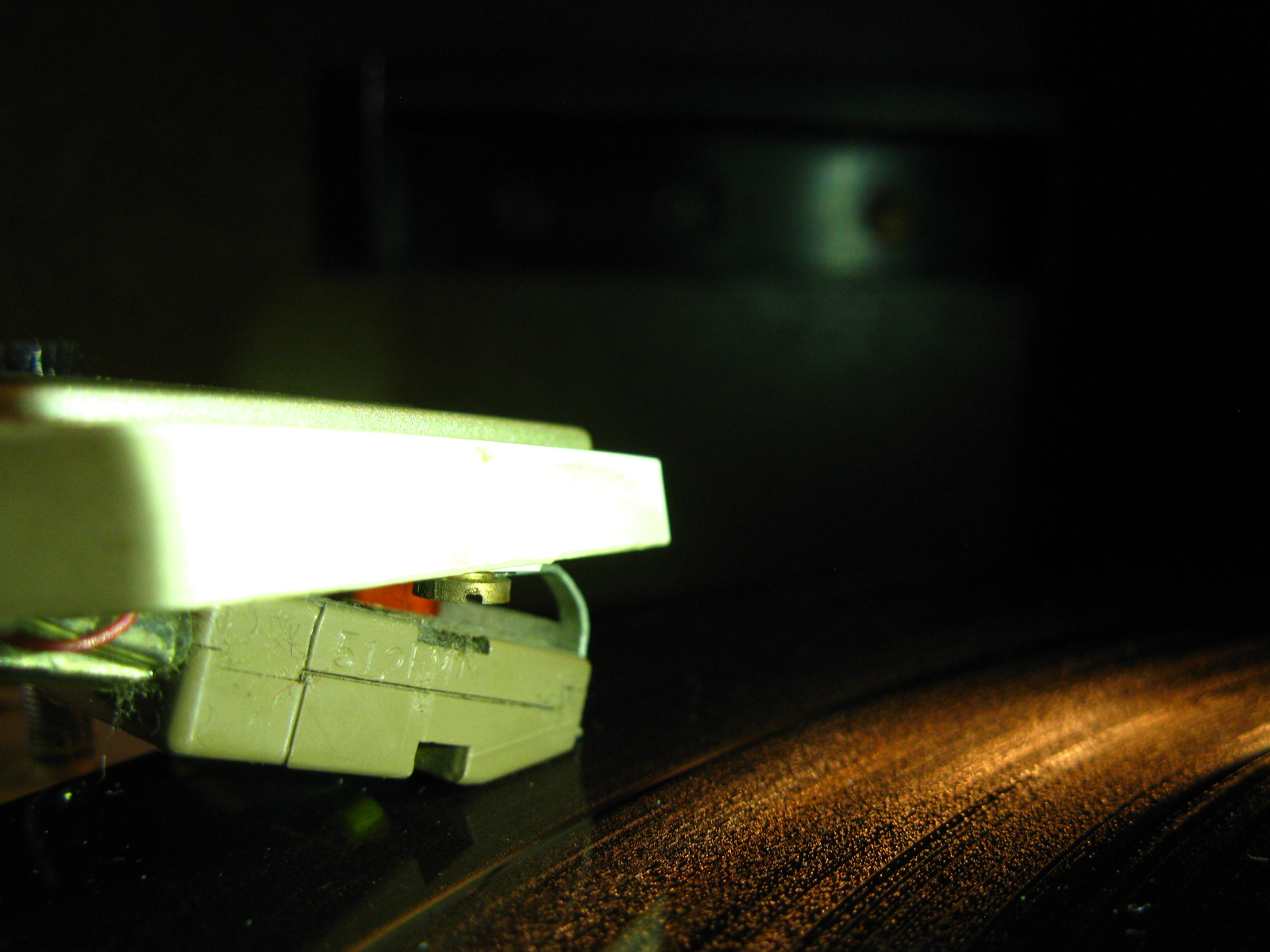

Another angle of the tone arm resting on the album
(629.92 KiB) Not downloaded yet
This is how the tone arm is resting on the album. You can see how the front clip for the cartridge is resting solidly on the album.
(752.51 KiB) Not downloaded yet

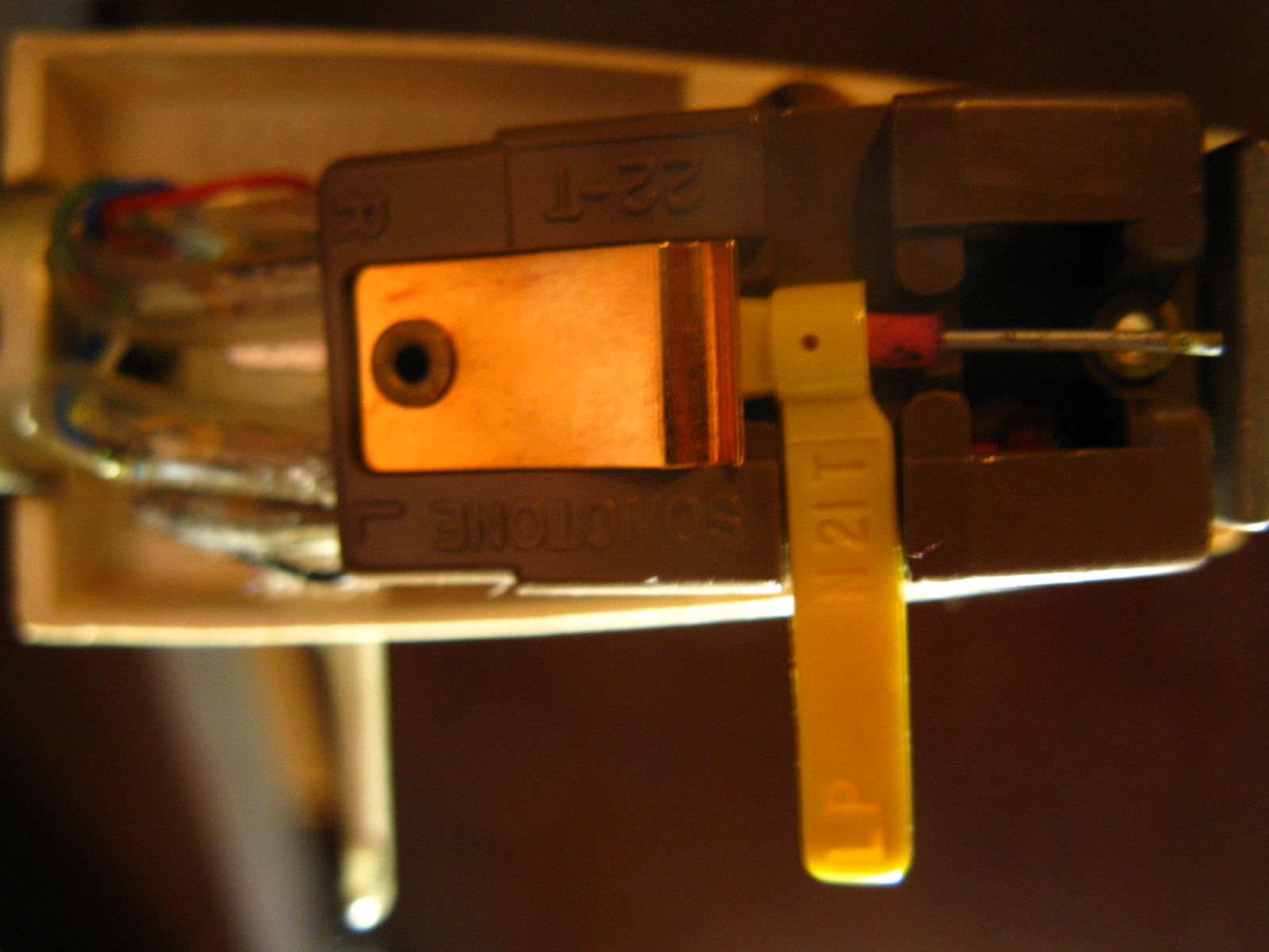

The needle in the cartridge
(780.23 KiB) Not downloaded yet

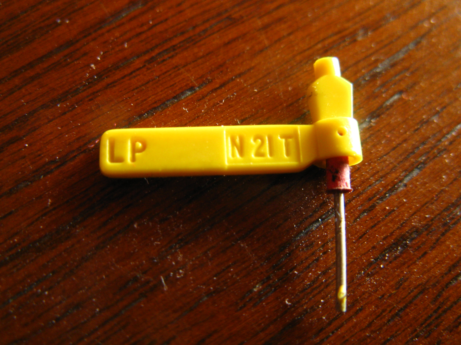

The needle that was in the cartridge when I purchased the unit. I purchased a new needle, but no better result.
(959.33 KiB) Not downloaded yet
The cartridge
(790.85 KiB) Not downloaded yet
Re: Packard Bell RPC-39
by MattTech » Mon Dec 26, 2011 10:31 pm
That cartridge is SHOT - the elements and yoke are missing, gone, history.
Someone messed with it.
See Gary Stork at http://www.thevoiceofmusic.com for a replacement.
Observe WHICH color wire connects to each pin - 4 wires - you don't want to get them mixed up.
Left - hot wire / Right - hot wire / Left - ground / Right - ground.
His EV5595-D is a good replacement - comes with mounting bracket and should perform like the original.
by Record-changer » Fri Jan 06, 2012 6:41 am
That is a Garrard AT-5.
The cartridge innards may have broken out during moving or shipping if the arm was not secured.
The stylus force needs to be checked whenever a new cartridge is installed in a spring balanced arm.

by Record-changer » Fri Jan 06, 2012 6:49 am
This is the tone arm setdown position adjustment, so the stylus lands on the lead in groove of the record.
This is the tonearm raising height adjustment.
There is another adjustment you did not photograph that is the stylus force adjustment. It is either at the back end of the white part of the arm pivot, or under the whit part.
Adjust the stylus force for the middle of the range specified on the cartridge.
Do NOT unscrew the tonearm horizontal bearing. You will have a very difficult time putting it back together again against the spring pressure.
