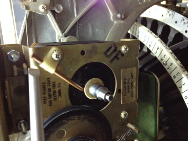

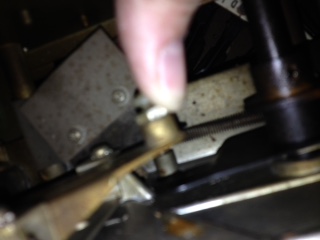

- I think we have a guilty little bugger as far as the tone arm is concerned. I see the nylon screw go in but it does not come out. So this would in fact explain why the stop pin does not go far enough to let the needle touch the records. Went to Home Depot and bought the same size nylon screw..
- I removed the light linked to 33 rpm as recommended :idea:

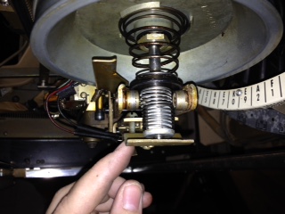

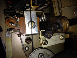

- I have taken so more pics of the actuator from the cam pilot assy. I do not quite understand what is the correct behaviour of this other nylon screw as it is screwed to anotherpiece of metal behind the one with the leaf switch on it .
The leaf switch near the end of the screw is NO. Is it supposed to close at some point?
- Found a small hole record, awaiting more homeworks to test that :D

Julie, the Cam Lever Switch looks bent out of shape. Those look to be normally closed unless opened by the lever. Do you have a contact bender (stupid question..I know..) Try carefully removing the switch so that you can bend the blades so that they will stay together except when opened by the screw on the lever.
I suspect that is the problem here. FWIW: I'd probably "lobotomize" the setup and eliminate the 33/small hole function if I were going to use it for revenue service.

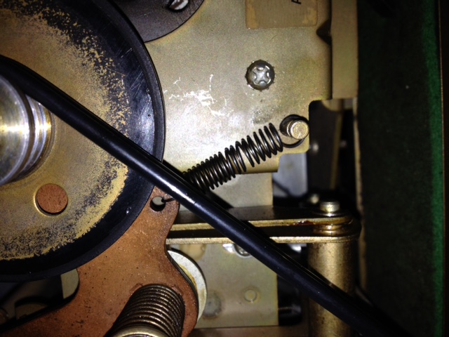

Julie, the spring for the idler in attached to a tab at the bottom of the pivot assembly with the idler.
It is shown here: http://www.retroaudiolab.com/pictures/e ... chrear.jpg -just below and slightly to the left of the idler. It may have been stretched or missing on your machine.

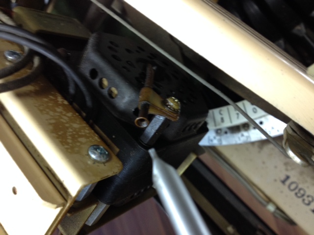

Now, how / where do I oïl the clamping mechanism? I must have to remove the Record Guide Front Casting?
I have a spray on cleaner degreaser No residue that I use in electronics, can that do for cleaning before greasing?
And what are these small tube going in the motor? Oil Pits?
And join here is a picture of the idle spring that does look like it was forced and now is too loose (the lower part seems extended no? ) So probably have to change it if I want that Drive Wheel to spin...
many thanks again

I do not remove the record guide--just use my "Valvespout" oiler to put a very, very, small, tiny, drop of 20 wt. on the metal parts you can see through the "circle in the (plastic) fan". Put another drop on the "rear end" of that assembly where the thin post enters into the shaft, and another drop or two on the spring area. Also-add MORE oil to the oil hole in the center of the TT shaft you oiled earlier !
Be extra careful with "spray" or any type cleaners--be sure it won't "eat NOTHING" !!
Yep--the two"tubes" on the motor are for oil !! Fill them, be sure that the oil is going down them--I usually stick a straight pin in the holes, otherwise it sorta just sticks without going down to the motor--fill them 2-5 times as there are large felts on the motor--
The spring has been "stretched--yes--replacement is probably going to be needed --Rob's "Gepetto friends" have struck --again-- Ron Rich
