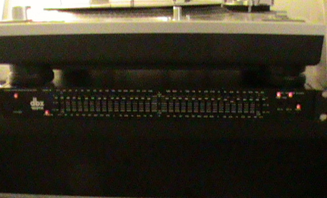

Here is the EQ I bought today for $84.00. Works well with my vinyl records. It does alright with my 78's although I need something better then my SHURE M78S stylus. Which works okay for my 78's after 1930, but I need a better one for the 78's prior to 1930.

by Rob-NYC » Sat Jan 12, 2013 1:31 am
Paul, I believe these are the instruction for your eq:
http://www.dbxpro.com/system/documents/ ... 1324060224
Generally, you start with the frequency sliders at the "0" -the midpoint and raised or lowered as needed. A light touch is best. It is likely that uppermost and lowest frequencies will not have any actual music from the old records so those may be set to minimum.
Again, set up the output from the TT for mono. On the 78's I dealt with all were washed with regular hand soap, rinsed with a strong stream of warm water to blast out as much crud from the grooves as possible.
In -some- cases a light amount of water film may be helpful as a lubricant in reducing surface noise on 78's Be careful not to use too much water as it can clog the stylus cantilever and muddy the sound. No big deal -just blow the stylus dry.

by Edisonfans19 » Sat Jan 12, 2013 7:47 pm
I was able to remove some of the surface noise, while still hearing the recording!
