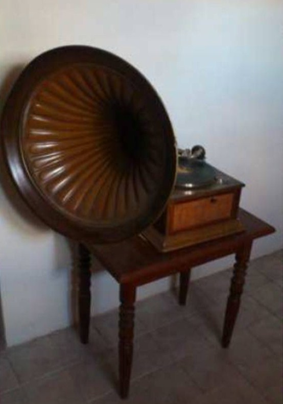

Recently I bought an antique horn gramophone (photo in Youtube links). I would like someone help me to understand why most of the records sound rather distorted.

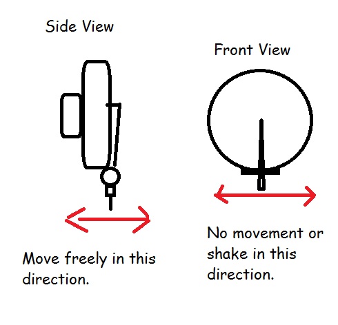

It's very possible that the blasting you hear is caused by groove damage. That's something you can check out with a magnifying glass, or even with the naked eye, if the damage is severe enough. Hold the record up to light source and look at the surface. Normally, worn grooves have a slightly greyish color.
It could also be caused by an improperly adjusted needle bar pivot. I can't tell, from the video, what type of sound box (reproducer) this is fitted with. If you could post a close-up photo of the sound box it would help.
As for the wobbling, it almost sounds like the needle was slightly loose, so that also leads me to suspect that the needle bar pivot's adjustment could stand some tweaking.
As a general rule, the needle bar should be free to move--with little or no resistance--in the direction required to play the record -- but there should be no movement or shake in the opposite direction.
Here's what I mean:
sound box.jpg (38.62 KiB) Viewed 2795 times
(CLICK IMAGE TO VIEW IT FULL SIZE)
HTH,

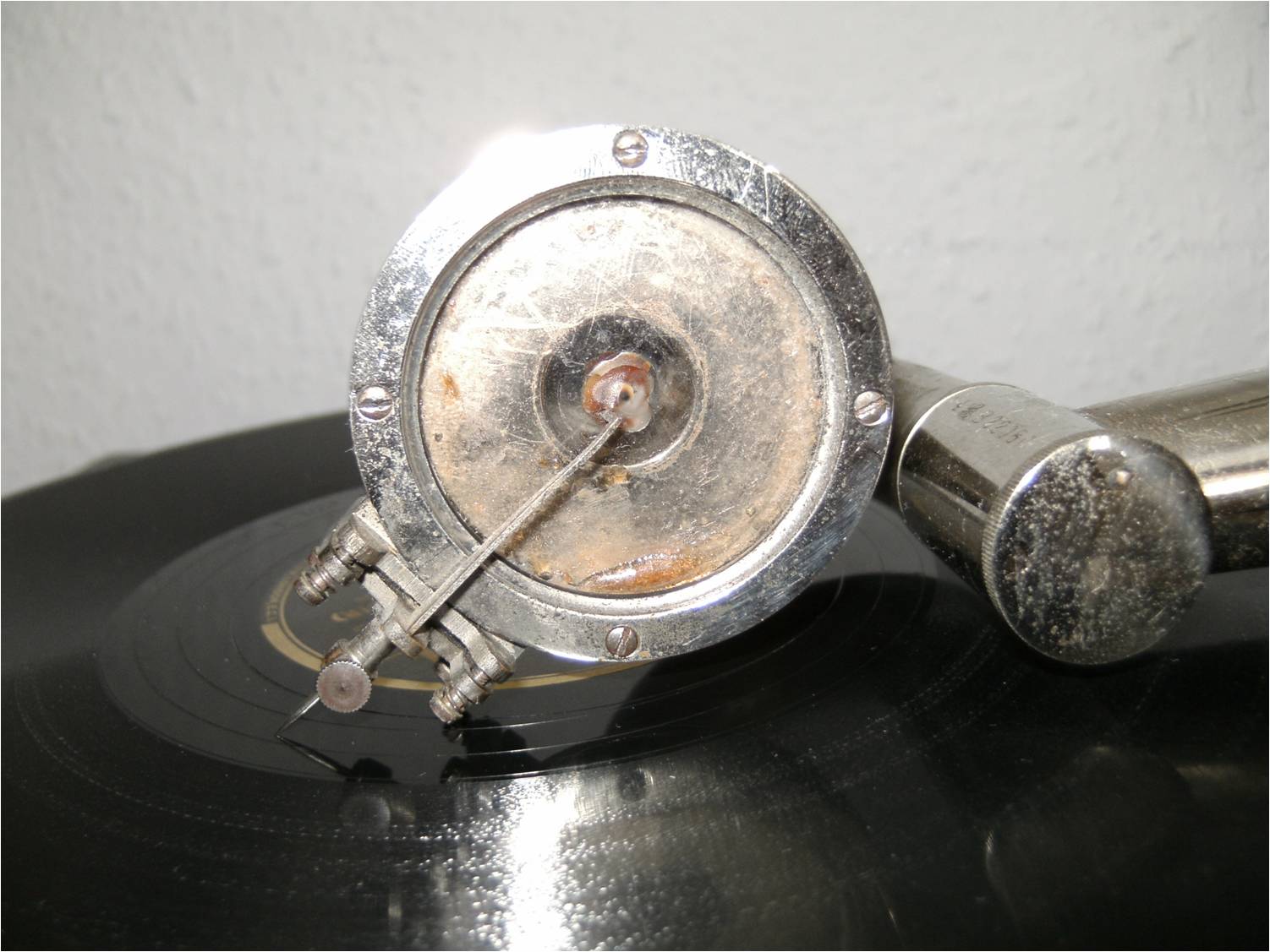

by Ksenia » Sat May 24, 2014 7:43 pm
Thank you for your reply!

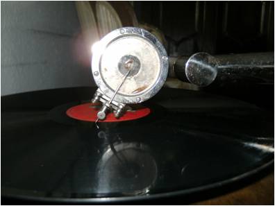

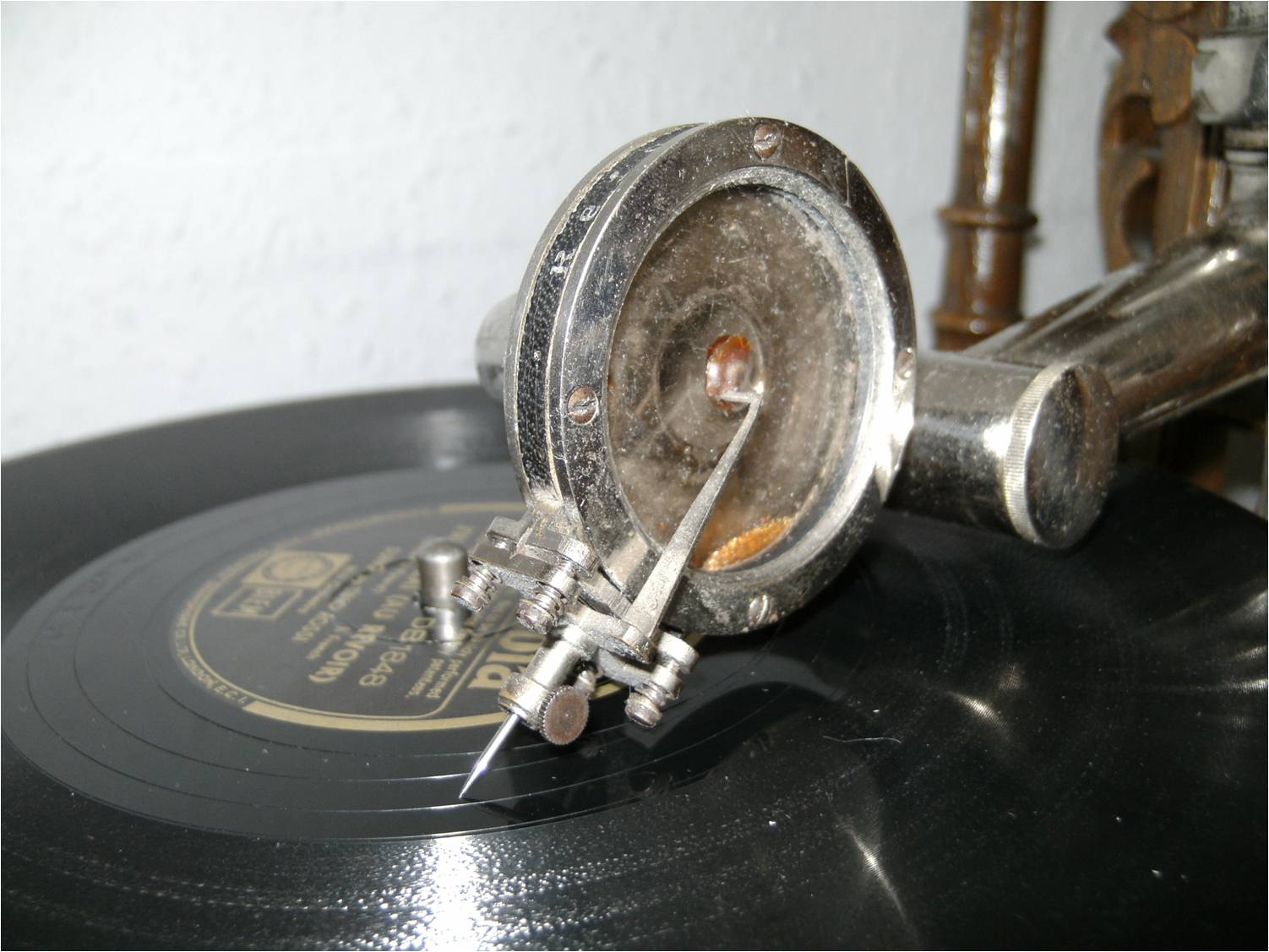

I can’t tell whether the needle bar pivot is improperly adjusted. When touching/moving the needle, it doesn’t seem to move in either direction. Close-up photos of the sound box are here below.
The grooves in the records (which have blasting/sound distortion) look damaged when viewed through a microscope.
How common are the sound distortions such as those in my sound examples? Over 50 % of my records (I have about 20) have sound distortions. I got the records from different suppliers.

Re: Gramophone problems – need help!
by Joe_DS » Sat May 24, 2014 10:54 pm
In answer to your question, "How common are the sound distortions such as those in my sound examples? Over 50 % of my records (I have about 20) have sound distortions. I got the records from different suppliers":
Quite common, unless the records are in "N" (unplayed) condition. A reputable auction seller will grade the records--such as N (new), VG (very good), G (good) or P (poor)--and provide an explanation of how the grading was done, such as a visual inspection, etc. He should also explain exactly what each grading range means.
If you buy them at a record shop, garage sale, etc., then it's up to you to do the inspection.
Most of the damage you hear may have been caused by some former owner who played the records with a worn needle, or played them when dirty. In some cases, the damage is caused by playing the record with a "frozen" sound box, or one with the original, hardened gaskets in place.
Looking at the photos of your sound box, It looks like it could still use a little TLC. For starters, you might want to clean off the excess sealant from the center of the diaphragm. (There should only be enough to just seal the joint.) In this case, it's best to detach and reattach the needle bar's foot. Prior to reattaching it, that's a good time to check the pivot. As noted, it should move with very little resistance in the direction required to play the record.
It might also be a good idea to hunt down a couple of replacement mica diaphragms, of the proper size, in case you want to do another rebuild. You could also experiment with different gasket materials, etc. Along this line, the diaphragm should not be clamped tightly between the gaskets, but "float" more or less, however the gaskets should provide an air-tight seal. If clamped or compressed too tightly, the tone will be shrill, and it will blast on certain notes.
For diaphragms, gaskets, etc., you can find suppliers by culling over the list of shops in the "Acoustic Gramophones & Phonographs" post that appears at the top of this forum, in the "Announcements" section.

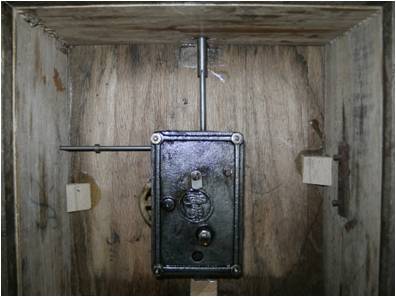

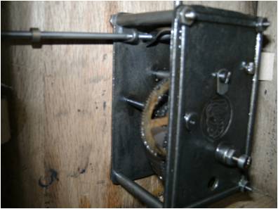

I don’t know the brand. I bought it here in Sweden, from a private person who isn’t a collector. The only marking is “Reform - Schalldose” (German for “Reform – sound box”) stated on the sound box. It would be nice if you identify the brand! I can send more photos if needed.
It looks like it has a single spring motor. I’ve tried 38 crank turns and got about 4.5 min. playing time.

There were probably hundreds of different brand gramophones that made it to the European market and produced well into the 1920s. (Switzerland was the principal supplier for off-brand models in the European market, though some were manufactured in other countries.)
In the US, the outside-horn gramophone market was more limited, because three manufacturers--The Victor Talking Machine Company, The Columbia Phonograph Company, and Edison--through a patent pool, controlled all of the key major patents until about the teens. This prevented start-up companies from pursuing the market until about 1916. When the patents expired, literally hundreds of companies sprang up overnight, (SEE: http://www.gracyk.com/makers.shtml ) though by that time, outside horn gramophones had fallen from favor in the US, and internal horn cabinet models were about the only ones being produced.
Many of the Swiss-made gramophones, I understand, had relatively short production lives, and were sold under a variety of brand names or were unmarked.
The name of the manufacturer may be stamped on the motor and that might provide a clue; as well as the reproducer. Unfortunately, motors and reproducers can be swapped over time, so you can't always go by that. Also, a gramophone sold in the European export market may have components supplied by a number of different manufacturers, housed in a locally made cabinet.

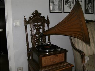

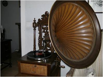

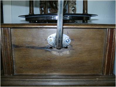

by Ksenia » Mon Jun 02, 2014 9:36 pm
Hello Joe,

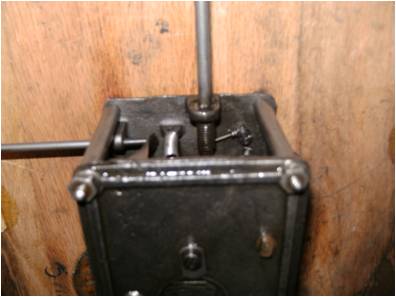

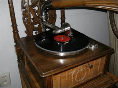

Some more photos are below. It may be worth mentioning that the turntable is approx. 25 cm (10 inch) in diameter. When playing a 30 cm (12 inch) record, I have to place an extra cloth disc underneath so that the record doesn’t contact the brake.
When approx, you think, the gramophone was manufactured?
I have ordered the gaskets from a supplier you recommended.
- Ksenia

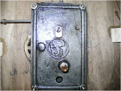

Sound box 1 - 5 cm.jpg (14.93 KiB) Viewed 2666 times
Sound box 2 - 5 cm.jpg (16.07 KiB) Viewed 2666 times

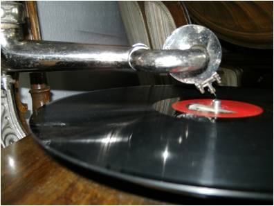

by Joe_DS » Tue Jun 03, 2014 12:26 am
I'm by no means an expert on these off-brand European models, but if it's all authentic, I'd say it was probably manufactured in the teens, or possibly earlier. I think the horn is particularly attractive.
The cabinet seems to be in excellent condition, and I don't see the patina on the finish I'd associate with something like this. I'm wondering if it was refinished at some point.
I noticed that you posted about this on the Talking Machine Forum. You may want to post these photos over there, since I now seem to be the only active member of Phonoland's Acoustic Gramophone forum and will probably be the only response you get here. (I'm a member of the Talking Machine Forum, too.)

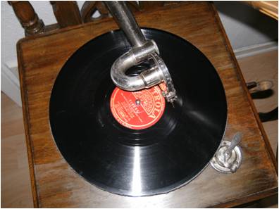

by Ksenia » Wed Jun 11, 2014 7:50 pm
Hello Joe,
The problem is now fixed.
I have replaced the rubber gaskets in the sound box. They are much softer than the old ones.
However, it seems that the main cause of the problem was the wrong angle of the sound box. After raising up the back bracket (as illustrated in the first photo), the angle of the sound box was corrected and the sound distortion is gone from almost all records.
Here you can listen to the same record being played before and after the angle of the sound box was changed: http://youtu.be/1jnGRw93xAc
- Ksenia
by Joe_DS » Thu Jun 12, 2014 4:05 am
Hi Ksenia:
I watched the video and you can REALLY hear the difference. That's how it should sound.
I should have noticed that the angle was too steep, but I was more concerned with the sound box, itself, and didn't really pay attention to it. Now, the way you have it adjusted, the tip of the needle properly aligns with the bottom of the groove, which is more or less V-shaped, instead of riding the groove walls as it did before. The proper needle angle, combined with the soft, fresh gaskets, should minimize groove wear.
