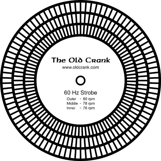

Thanks for the information! I ordered all of the pieces that I will need after watching the video. I like to fix my own car, motorcycle, whatever, so I am going to try to figure this out too. I won't be playing any more records until it is fixed. I was working on the speed with a chipped record that came with the record player. It was a real steal because the shop owner thought that the speed control was broken. After checking out a manual, I figured out that he just didn't have things set up right. Is there a good way to reliably calibrate these though? I have a good ear, so I kind of tuned it based off of that so far. I think the hardest thing for me to find is going to be the screw for the springs for the needle. I am missing one. I ordered a new pair of springs, so I will have to find one somewhere! I am so excited to get this thing working! I just want to find a bunch of christmas songs for next winter. :D

For calibrating the turntable speed, you might try a strobe disc. There are a number available online, which you can find by doing a google search for
78 strobe disc
Here's the one I normally use, which you can copy and print if you want:
(Right click, select VIEW IMAGE, Print)
I don't know if you're familiar with how a strobe works, but all you have to do is cut it out, punch a hole for the spindle, set it on your turntable, and shine a 60 watt light bulb on it. Adjust the speed of your turntable and when it reaches 78 rpm, the middle "graph" will appear to stand still. (The bars won't move.) Slowing down or speeding up the turntable will cause the inner or outer graphs to stand still when you reach their respective speeds.
Not to throw too much at you, but you should know that many early 78s--those made before about 1930-- were not always recorded exactly at 78 rpm. Some spun as slowly as 60 rpm, and some as fast as 90 rpm, but the average range is about 76-80 rpm. It often takes a musician's ear to get the speed just right. You can download an application from this site that allows you to create strobe discs for just about every speed imaginable -- http://www.78rpm.com/rescat/strobe_info.htm
Along this line, since you're new to the hobby, I'll also mention the fact that to minimize record wear, you should never play more than one or two sides of a record with the same steel needle. And never remove a used needle, turn it and reinsert it to play another record. That will instantly destroy the record groove.

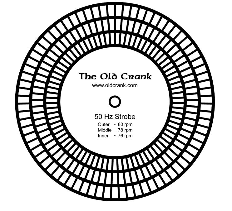

Does the number of hz matter?
We're on 50hz in the UK.
Surely it's just a test of the turntable speed, the number of cycles in alternating current shouldn't make any difference?
Re: New to Phonographs
by Joe_DS » Sun Mar 31, 2013 11:47 pm
DoghouseRiley wrote:Does the number of hz matter?
I don't know if it matters or not, but I often see the option of 50 HZ for the discs for people on the "European system."
Here's the Old Crank strobe for 50 HZ:
50 HZ strobe disc.JPG (110.22 KiB) Viewed 1883 times
FROM: http://www.oldcrank.com/articles/strobes/50hz.html
JDS

Yes "Hertz matters"--You are comparing the lines on the disc to the "flicker" of the power, in order to judge the speed. It makes a difference if you have different "flicker" rates.
BTW--an old style (magnetic ballast) with a fluorescent lamp works better then an incandescent lamp. New style electronic ballasts are useless for this--

I can understand that now, I thought it had something to do with the way your eyes conveyed messages to the brain, in the same way as Victorian Zeotropes work
So how does it work on "wind ups?"

It works very well. Just center it on the spindle, so it lays flat on the turntable, then give the machine a full winding, release the turntable brake, shine the light on the strobe disc, and then move the speed control lever (or turn the knob) to speed up or slow down the turntable until the strobe shows the correct speed. (Virtually all spring motor gramophones have a speed control knob or lever.)

It maters not what powers the turn table--wind-up, electricity, steam, "Petrol"--
The strobe disc is setup to allow your eyes, to compare the turntables speed in relation to the flicker ( Hertz) of the lamp. The difference between a 60 and 50 Hz is the distance between lines.
Ever hold your hands up, and move them in front of a "strobe light"--same thing--
