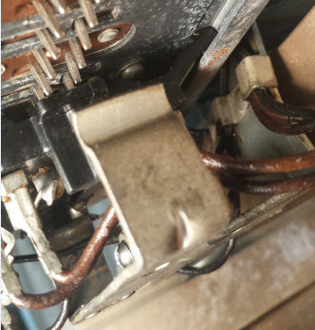

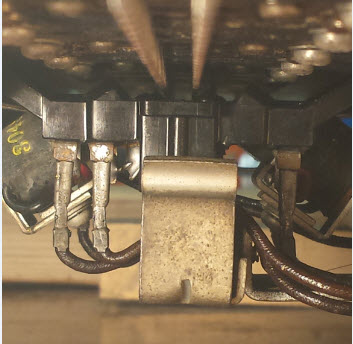

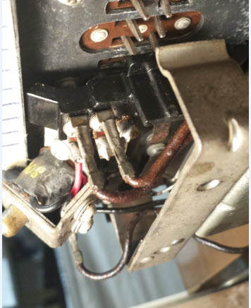

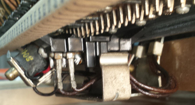

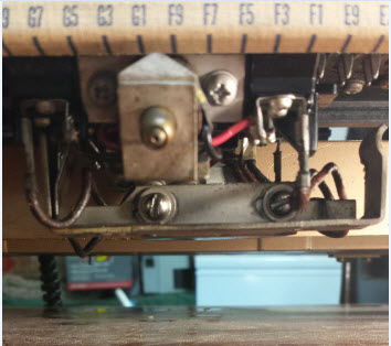

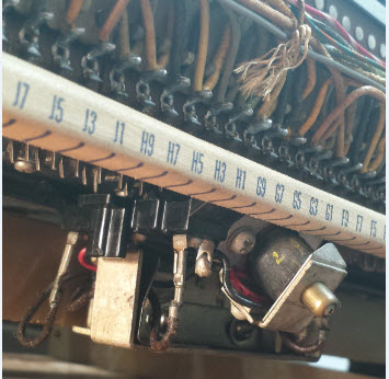

It looks okay, i think, i have attached some pics of the SA\frog and a link to a short video of the problem when scanning left - thanks again for your help with this.

Re: SEEBURG R - RESTORATION - MECH PROBLEM
by Ron Rich » Sun Sep 25, 2016 6:38 am
Hi Gary,
I can't really tell from the photo's--but it appears to me the plastic frog is sitting on top of, rather then inside the spring, on the left side ? If so, that has to be resolved--look at your working mechanism-- Also on the vid--obviously the sensor is NOT passing the pin, on the first try--this is usually a result of the same frog alignment problem--

by gmendo » Sun Sep 25, 2016 4:19 pm
Thanks Ron - yes the frog was not positioned correctly in the spring - so after correcting that i have tried to follow the procedure in the manual "Contact Block Alignment". After i loosen the screws on the contact block (frog) and try and position the contact block levers A1 and A2 (centered) between the left and right contacts i do not have enough adjustment. I move the contact block all the way to the left but the A1 lever is sitting on the left contact - it needs to move a bit more to the left in order to be centered ... what do you think ? Are there any other adjustments i'm missing ? Thanks

Hi Gary,
Your problem remains that the "U" shaped bracket is not securing the frog properly. It is either bent, or mal-formed from shipping the phono without tie down bolts installed. It appears that the bracket is lower on the left side in the earlier photos--is that still the case ? If so, is the spring forcing the frog to the other end of the bracket ?--It should be--
Fix that problem and watch the sensors as you play A-1/A-2. The frog MUST be adjusted so that the sensor passes the selected pin prior to the record arriving on the ramp. This MUST be true on both sides, of the records, and at both ends of the SAU. (A-1 and K-0) end. Ron Rich
