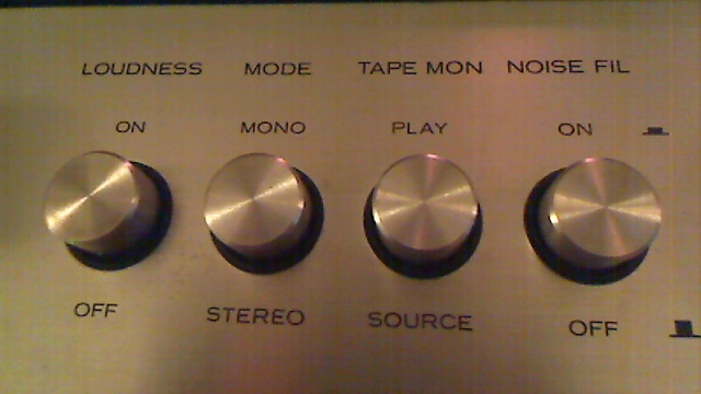

by Bobby Basham » Fri Sep 16, 2011 4:01 am
How about listening through a set of headphones. You will definitely hear the sound "centered" in a mono recording. It's just like switching from FM to FM/Stereo while wearing headphones, the sound will broaden. Some component amps/receivers back in the day have a Stereo/Mono switch, and you can toggle that back and forth to hear any differences.
You may get quicker results with less effort. --BB
