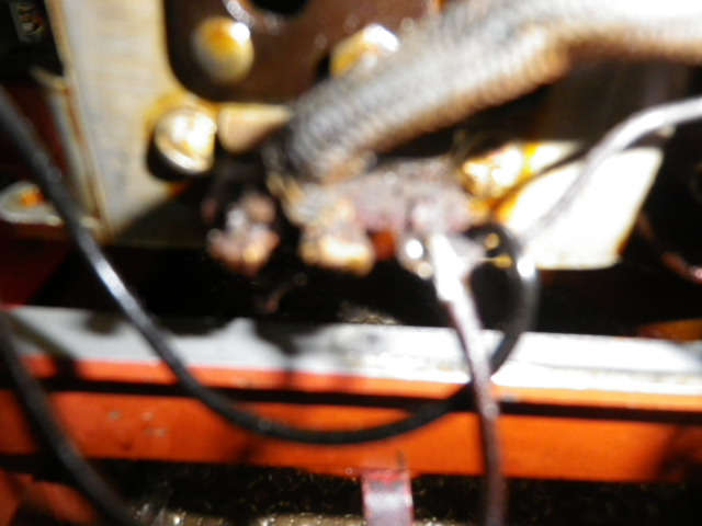

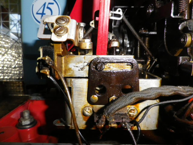

The tone arm has a bias towards the center of the record. Starting, the trip lever is just up to the reset plate, after I release the tone arm there is a gap of about 1/8 of an inch between the trip lever and the reset plate.
I am having dificulty determining what you mean by "counterweight under the tone arm assembly". On page 2163 of the manual at the bottom of the page it refers to "Roller Type" and "Sliding Weight Type". I do not see either in the pictures I am attaching for your review. Sorry about the blur, if there is sometype of adjustment placed as shown on page 2163 of the manual, how would you get to the adjustment under the tone arm?
The only possible adjustment I seem to find would be to put a screwdriver through the left hole in the black plate with a slot that accesses a scew that puts pressure on the tone arm. If this is not the adjustment you are referring to then I need to try to figure out where this "counterweight is????
Best
Darrell

The Service Manual has a procedure for this--shows the counter weight and tells you how to adjust it--One thing it does NOT say--pivot points must be oiled first ! Do you have a gram gauge ?

Also, what is with that tonearm spring? That is not going to help things.
Re: Seeburg C Trip Switch Pressure
by Ron Rich » Wed Aug 27, 2014 4:28 pm
Darrell,
Ah, yes--that "tone arm spring--?? I was going to comment on that yesterday, but my computer INSISTED on "scanning"--
Seeburg used different type/strength/length springs on the tonearms, prior to 1967 ( and three different types after 1967), depending on which cartridge was supplied with which model.
The "correct" spring that should be used when using a 345-03x type cartridge is the one supplied with the model R, and up thru the rest of the mono models. If using the OEM needles (either green, or tan) the pressure should be set between 4.5 and 5.5 grams, using a gauge (I prefer to be on the lower side--no higher then 5 gm).
One "other point"--I often see the spring supports "badly bent" on these models. Some "adjustment"of them is possible to achieve the proper pressure, but be careful, as they will snap off ! Ron Rich

As to the spring, I have replacement springs from A-1 jukebox, I just have not put them on, I will use a gram gauge when I do put them on. When the "A" side (and only side that has a problem) is playing if I apply very light pressure on the tone am to move it against the record I get better sound and the skating stops, so I would guess that the spring was stretched in an attempt to apply more pressure on the tone arm?
I have reviewed page 2163 of the manual (several times) and that is where my problem is and why I posted the pictures, as I cannot locate a "Roller Type" counter weight to adjust by turning or the "scew" for the "Sliding Weight Type" adjustment, picture shows this screw on bottom of counter weight but does not explain how you are supposed to gain access to it. Looking at Rob's picture I see a screw on the counter weight, so I take it I have to remove the tone arm assembly to get at that adjusment screw? For some reason it seems to me that it should be easier than complete removal of the tone arm assembly to make this adjustment!
Is this the adjustment?
Best
Darrell
by Ron Rich » Wed Aug 27, 2014 7:13 pm
Hi Darrell,
NO--the adjustment is just what's shown on that page ("the screw" is used only to put the correct tension on the wheel--should NOT be messed with, in any way!)--You can get another view of it on the parts page--look UNDER item one (lower left side of drawing), where it's partly shown, and the in the "break-down" above as items # 78/79.
One other "factor" sounds as if it's in play here--stiff tone arm wire. As a "quick check", play a record, stick your hand under the cradle, catch the wire at the point it just before it starts to curve upward, and move it, lightly, in the in/out direction. If the pressure is correct, this should NOT affect the needle. If it does, you need to replace the tone arm wire, as it has become too stiff. Ron Rich
