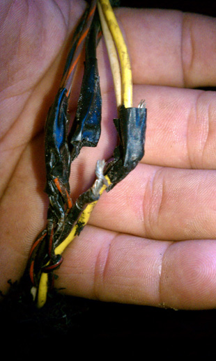

well i checked the ground on the mech it was tight but i cleaned it anyways
but on the one mech plug in harness it was wrapped with electrical tape so i up wrapped it to find the wires twist together
i tugged on the ground and it just pulled apart and i said to myself "there it is" :D
so i soldered and heat shrinked all the wires and crossed my fingers and fired it up......only to hear that awful noise :cry:
so i tried a 5879 tube same thing :cry:
but i did find out if you turn the avc knob to off it doesn't make the noise???
